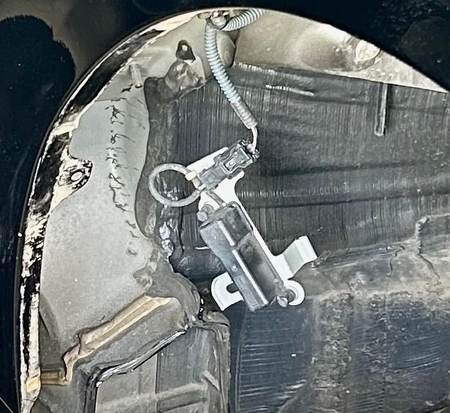

Thank you very much for the information. I removed the right-side liner and found a dangling cable with two wires, so I’m guessing the sensor is missing. I’ll need to order one along with the connector and reinstall it. While checking the part number (8976B-50011), I got confused about whether there are two initiators as shown in the diagram. I also checked the left wheel liner but couldn’t find anything there, so you’re right—it’s only on the right side. I’ll go ahead and order the part, install it, and hopefully that will fix the issue.

Talking Issue fixed!
Originally Posted by tammap
Here you go. Best of luck!
I installed a used sensor after finding out it was missing from the car. Now the tire pressure warning is gone, and all four tires are showing pressure readings.
Thanks a million for the documents and the guide. Cheers!
