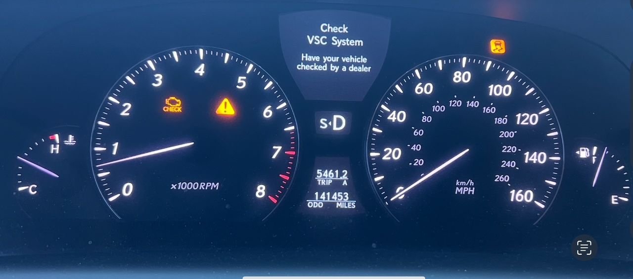

Three warning lights on the dash.
Code reader shows P0171, P1170 and C0300
Replaced fuel cap, replaced battery, did not help.
Next planning to clean MAF sensor
what might be the cause? Thanks in advance for your help.

Got checked by a very reputable mobile mechanic.
Smoke test and visual inspection, no air leak
Scanner showed no misfire, plus spark plugs were replaced 30k mile ago.
MAF sensor checked out fine,
only thing left are fuel injectors/fuel pumps.
Suggestion was to run fuel injector cleaners and go from there.

Check your battery too. Electrical issues caused by failing batteries can cause these lights to come on.
Old Mar 21, 2025 | 10:55 AM
texas008's Avatar
texas008
Joined: Jan 2014
Posts: 778
Likes: 130
From: texas
yes forgot to mention that
I replaced the battery 2 months ago (old battery was a 2.5 year old costco kirkland battery)
also replaced gas tank cap about 2 months ago.
