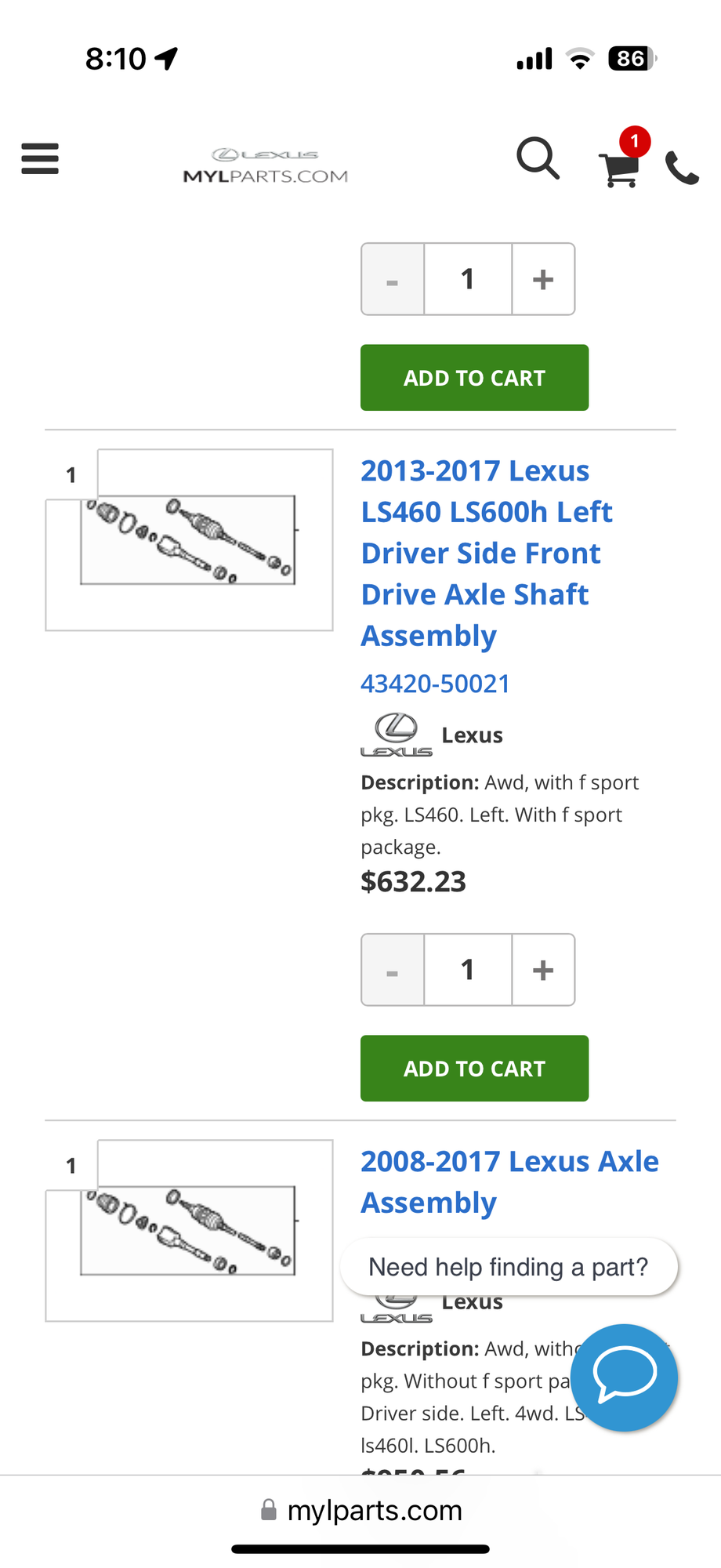

Mine's 2013 awd fsport and this is from mylparts.com

This part is almost half the price from another genuine Lexus parts dealer. Before I order. Is this the right part for the Fsport front drivers side?
Old Feb 8, 2025 | 04:53 PM
Posts: 26,052
Likes: 4,328
Without your VIN I can't verify 100%.

Details state it’s for Fsport drivers side AWD. The more expensive $900+ cv axle is for AWD without Fsport. Strange how I thought the beefier sport would cost more.
Just ordered. Total ran up to this. Bought in Feb 2025. Just fyi for anyone who finds this helpful.
