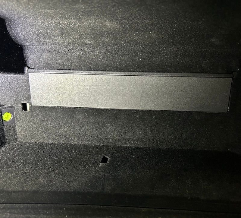

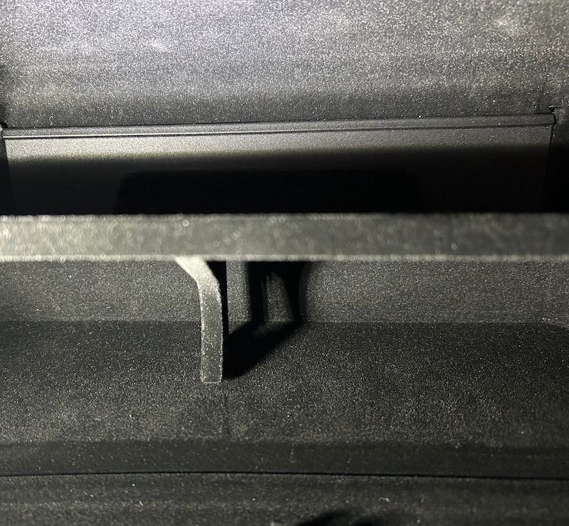

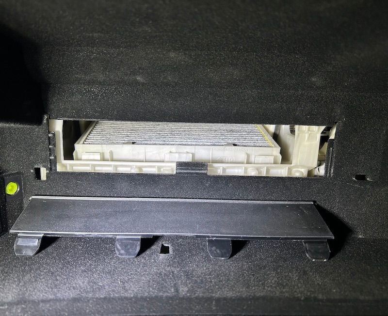

Well I believe it turned out to be the cabin filter not properly seated. I put it on recirculate and opened the door and pushed down on the filter. Put it on Auto and set the temps at 72 and turned off the car. Waited a couple of minutes and restarted the car the auto was and the temp was still on 72. I will recheck again in the morning. I had not hooked up my techstream computer nor my Carista to see if there were any codes.

I remember reading a few years ago that if you don't follow the correct procedure for changing the cabin filter you can damage the unit and one of the symptoms is the AC always starting at 75 degrees.
Old Jan 21, 2025 | 05:17 PM
Posts: 18,307
Likes: 1,785
Correct, do not move the door by hand. Ever.
