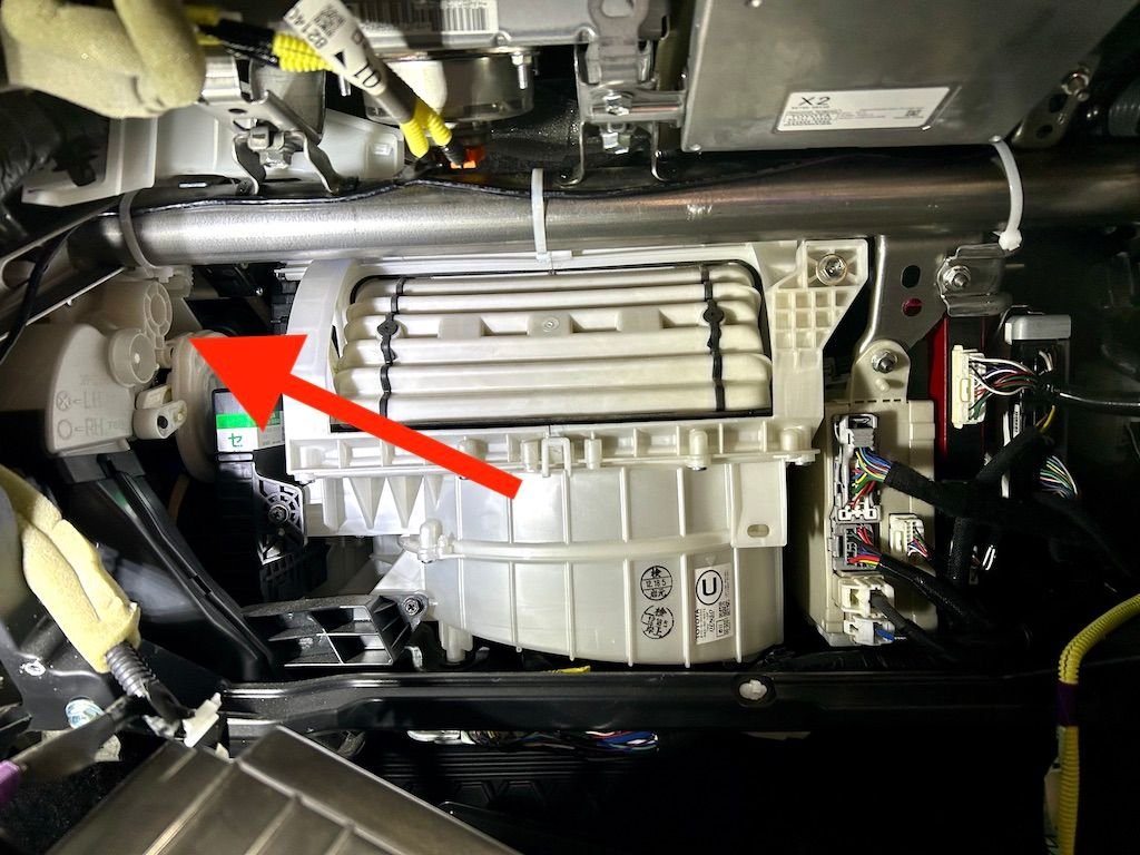

Originally Posted by DJWLDW
Does anyone have any ideals on about how much this will cost me to fix?
I've never had that problem on my car so I don't know, that 1442 code is for an air inlet actuator/servo and there are 2 or 3 of them listed for the front HVAC and a few more if you have the rear heat/ac. You can get the parts numbers from the link and just scroll down to select front or rear, your price will be less in the USA.
There have been a few people that had the servo/s replaced but I can't find any price on this job, if it's the front that's not too bad to do yourself if you like to do your own repairs...I've been in there to run some wires for cameras and sub power cables but you would need to know the correct actuator because they are numbered and I'm a little sceptical that it's the recirc servo because you can turn recirc on or off and everything still works normally. I think it's going to be the air mix on the side the arrow is pointing in the picture, I've read that dealers like to change all the servos to guarantee success. Good luck
https://www.lexusoflondonpartsdirect...V8-AT-RWD.html
