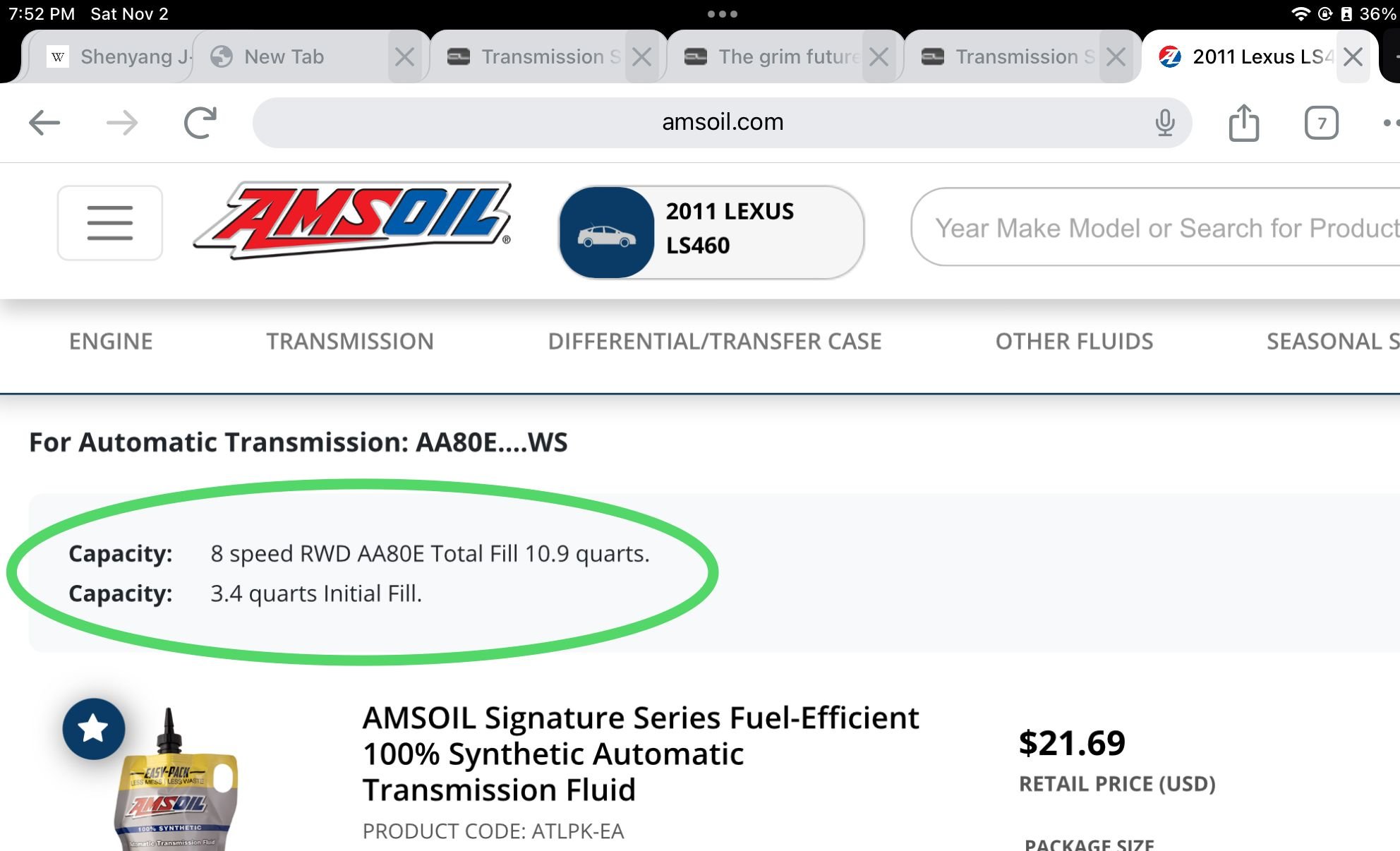

Amsoil (I use as a reference as they have instant, easy, accurate volume and rec. data by model) says your volume is 10.9qts total, and 3.4 for the pan. If you did 2x pan drain/fills over a short period of time, you’d be in good shape to then push the next one out the normal 25 or 30k interval.

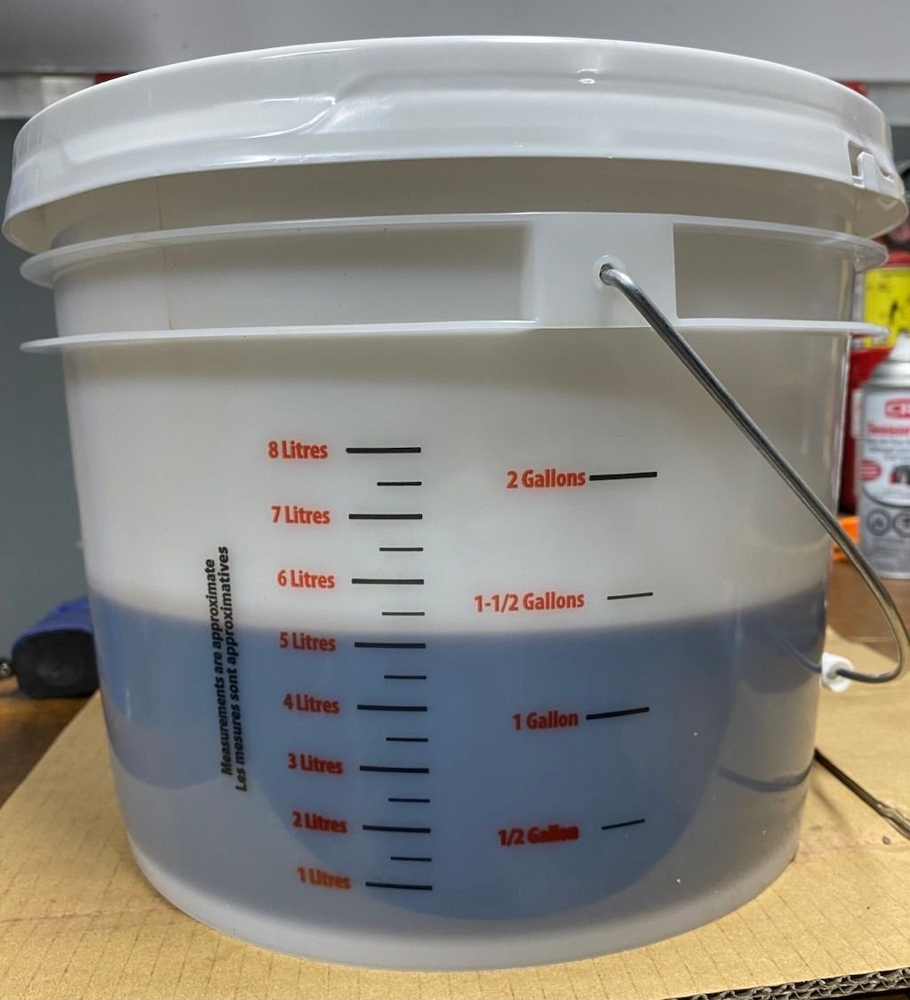

I have to disagree about the filter, removing the pan can give you a better idea of what's been going on there by the condition/what's on the magnets and the appearance and colour of the connectors on the valve body if overheating has happened plus the fact that the fibrous filter is 13 yrs old.
This picture is approx what will drain if you do a filter change, this was the first drain so I added 1/2 quart more because it's faster to drain some fluid when level checking than adding fluid during procedure. It will cost approx $ 200 ish more for the oem filter and gasket.

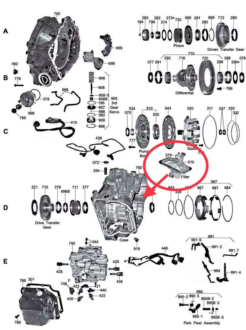

Aisin does not even put real filters in some transmissions - are you not aware of this? Are you pulling an AW of AF transmission and power train every time you do a fluid service, to change the filter? It’s in the case and never gets replaced.
Fluid in an ATF is NOT like engine oil and filtration is not the same. Posts like this is how we get silly myths…
“Stainer” in an A340, pointless to change. Look at the “filter material” in the window. Many U series are the same.
Filter location in an Aisin AF/AW; you have to pul the trans and OPEN it to change it. Do you really think Aisin views they filter as critical?
You moved the goalposts once again, the AA80E and the AWD version both have fleece filters that are easily replaced. If you ever did a proper service on one you would know that
Aisin says to change them at 60k miles and I listen to what they say. Stop changing the conversation to something we weren't discussing or irrelevant to the XF40 platform.
