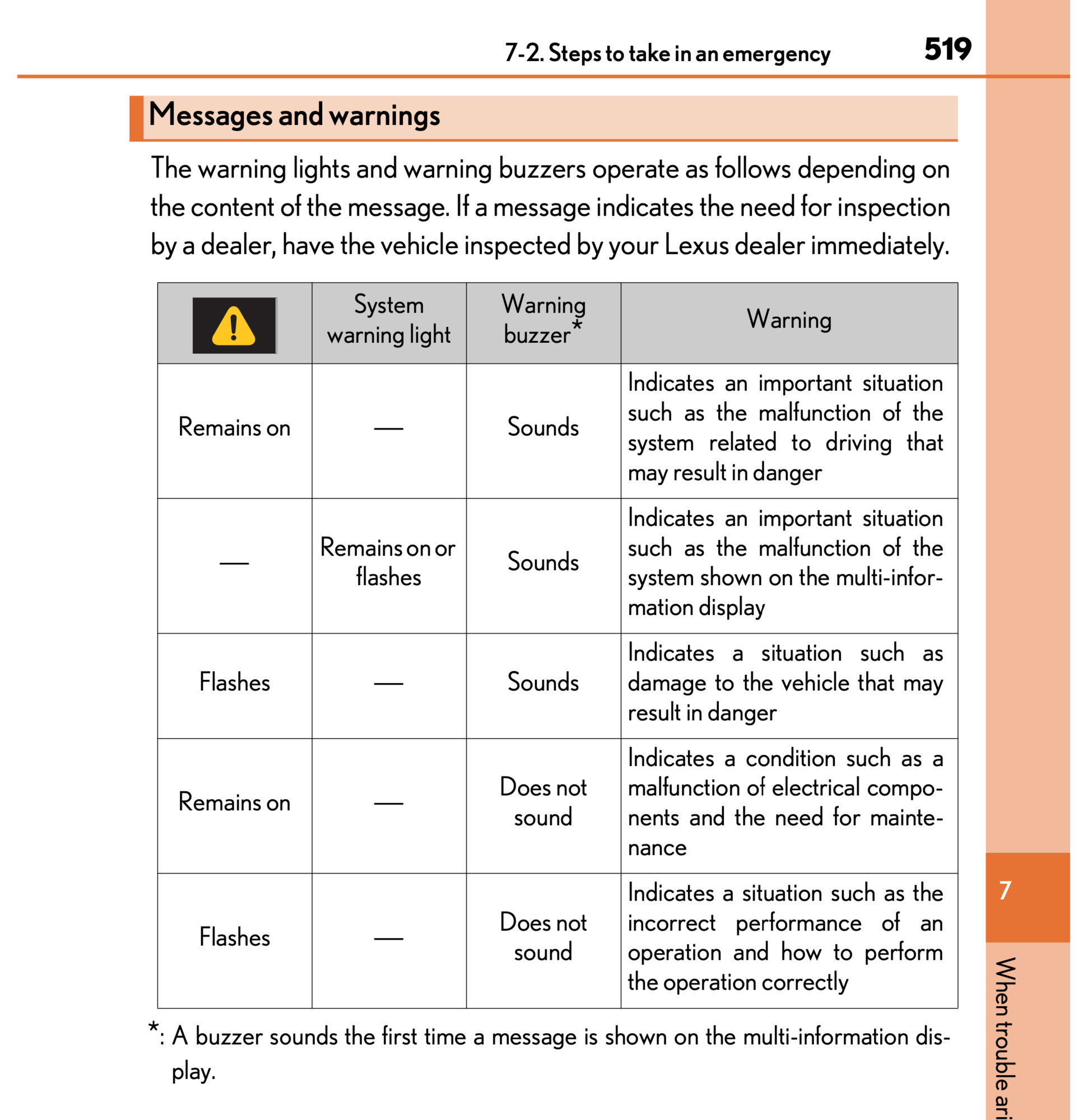

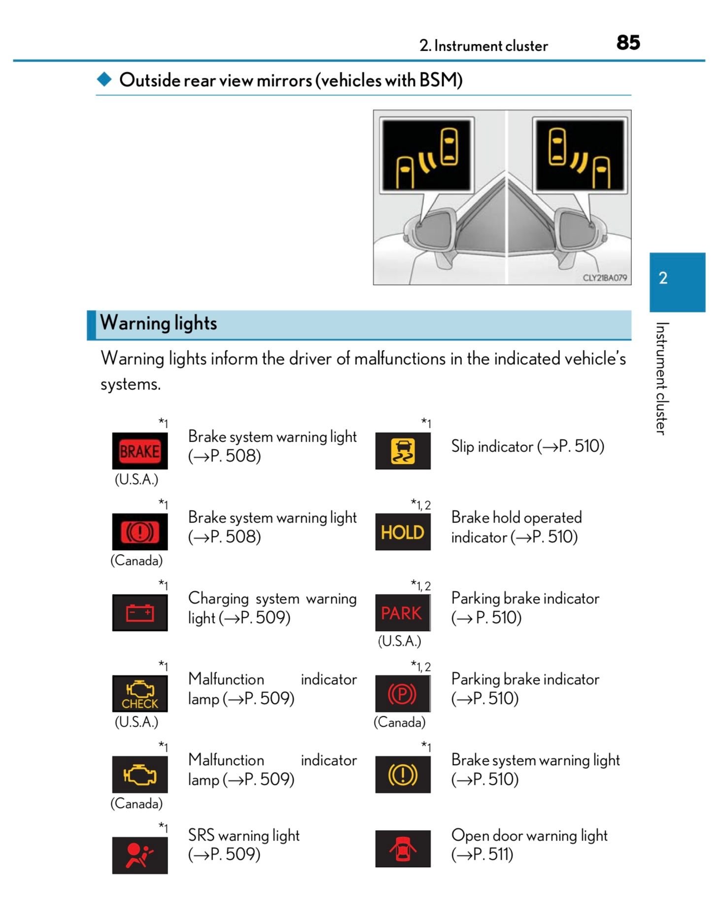

I think maybe the salesman is gaslighting you.
Here are some clips from the 2017 LS460 Owner's Manual:
