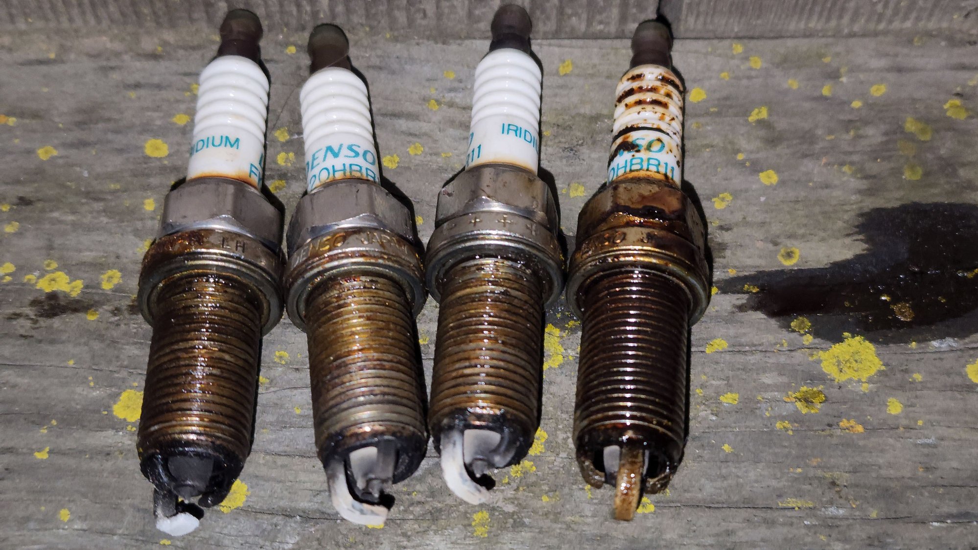

I've also attached the condition of the plugs that I replaced, possibly the original plugs from the looks of them. Obviously the engine has been running lean for some time. Top Pic of plugs is passenger side starting with the order the plugs came out, last one being from the firewall. I know the valve covers are leaking too. That's next on my to- do list.
second pic of of plugs is driver side in same order.

You may have a valve guide issue based on that plug on the right......

I replaced the spark plug seals. They were cracked especially on the passenger side. Could it be that oil was leaking from there? The coil pack had some oil on the tube also.

At this point I'd do a compression check on the engine. I'd want to know if the engine is basically "healthy" with good compression before I threw more parts at it first. If all compression readings are in range.
Standard compression pressure: 1400 kPa (14.2 kgf/cm2, 203 psi) or more
Minimum pressure: 980 kPa (9.9 kgf/cm2, 142 psi)
And fingers crossed, your compression is good, then I'd proceed to check everything else involved, since any number of things can cause an engine to perform as if it has power loss somewhere.Could be anything from a couple dead coil packs to a restricted exhaust system but first things first, I'd want to know that this engine is basically sound before putting more effort into fixing it.
