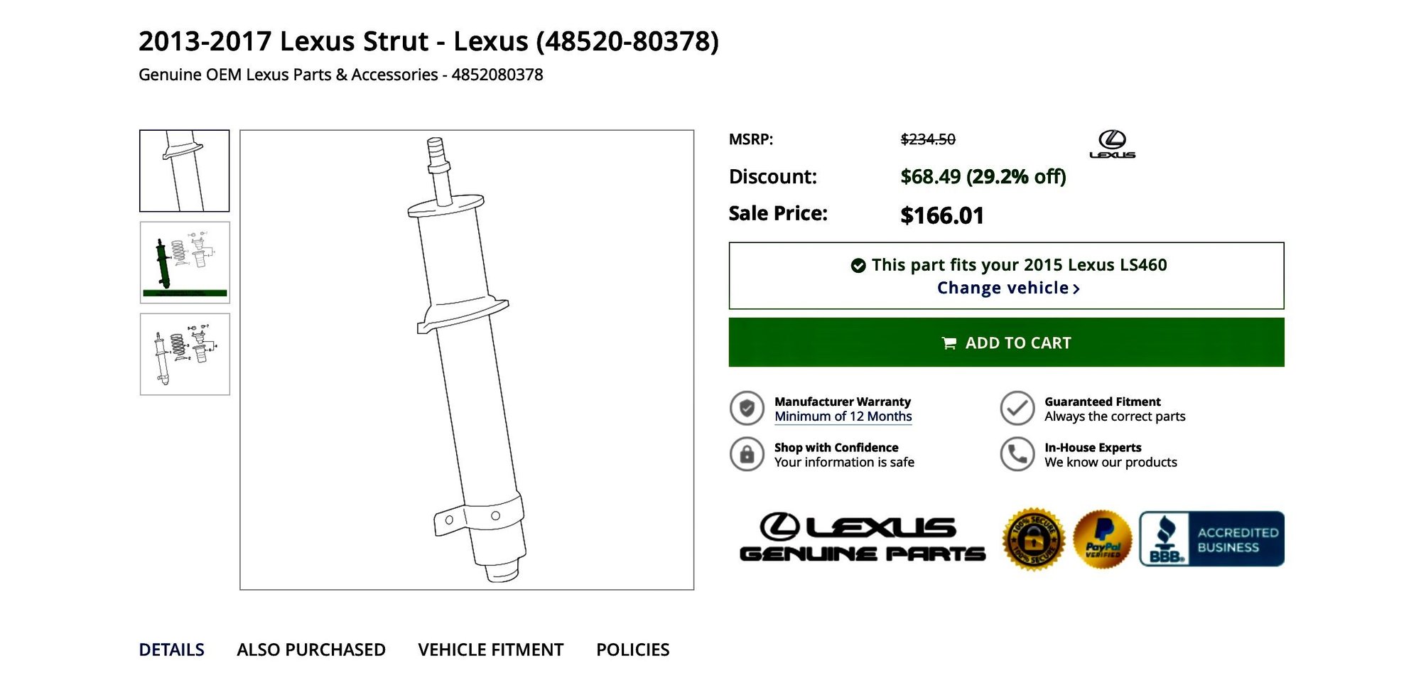

What is stopping you from getting non air struts from a 2015 ls460l ? you would have to buy all the other associated parts springs mounts etc and leave the avs actuators connected to avoid having a warning light on but it would be cheaper for sure. Looks like the fronts bolt on to the existing strut forks you already have.
https://www.mylparts.com/oem-parts/l...rut-4852080378
