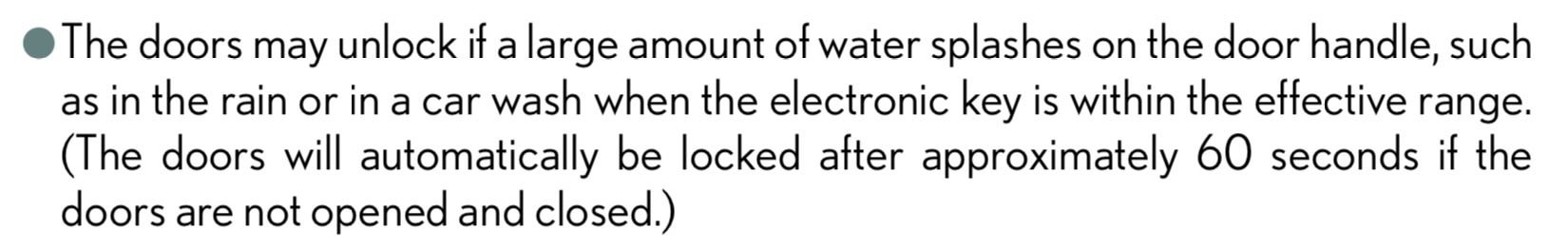

Your owner's manual cautions that this is normal:

Thanks for finding that, I'm glad to hear it's a normal thing.
