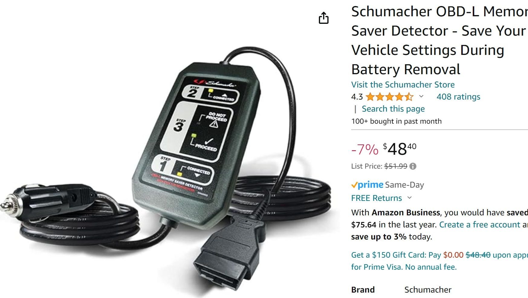

Perhaps this contraption might have avoided those problems - I'm not being sarcastic when I say "PERHAPS". I used a different memory saver device than the one in the image, the last time I had to do work on my other car, 2002 Camry V6. All in the hopes of avoiding any codes or any other issues from disconnecting the battery.
Well the first memory saver I used held no settings. The dumb thing was powered by a 9 v battery and that was supposed to hold the settings in the device. It didn't. Come to find out from Scotty Kilmer's YT channel the memory saver device needs at LEAST 12 V DC power to hold any settings.
So I threw the first piece of crap away, and got the device below, in hopes it might actually hold some memory settings next time.
Yes, keeping the settings isn't just about radio stations like it was 30 years ago. Many systems are always on idling in the background. Because of this we get frequent threads about why is my battery low after I let the car sit unused for several weeks. A device like this is good(read directions before buying) or even a battery maintainer attached to battery cables will work.
