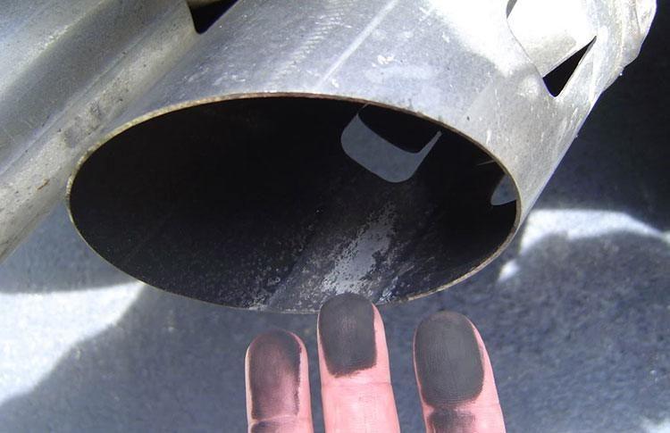

So I’ve been noticing that the 2007+ Lexus LS’s have lots of black soot in the tailpipe. The 460’s are the worst even the 2013’s. The LS 430’s have the least if any. The 600’s have just a little bit. Is this a bad sign for longterm reliability? And is it harming the catalytic converters and oxygen sensors? I’m curious if any of you have it on your car. Just rub your finger on the inside of your tailpipe.
Not a Lexus in the picture. Just an example. The right most finger is what the 2013 460 I tested looked like. The 600 had very little, even less than the leftmost finger. The ls430 hardly had any.

Normal for DI engines, nothing strange at all. The high compression+DI causes soot almost like a diesel engine does, that's why you are starting to see particulate filters on really new gas engines from euro-origins. You don't see it as much on the 430 since it was a port only engine that fuels richer vs a much more exact DI primary car like the 460, on DI only cars or stuff the like 460 when you go full power you can actually see a "poof" of carbon if you haven't gotten on it heavy in a while.

Totally different concern, it's intake valve deposit build up that twin injection prevents. Exhaust pipe soot doesn't matter at all

You are totally incorrect there, it has LESS buildup than richer fueled engines in the cats and on the O2. One of the principle advantages to DI is less emissions since fueling is more accurate leading to less work for the cats and less stain on the O2s from unburnt fuel.
Again it's a non-issue, port injected cars are far more likely to kill cats than DI ones if everything is working correctly on both.

Cats operate at about 700 degrees F up to 1200 F. Soot forms and collects as it cools out the tail.

The oil consumption is not related at all. Read more about how DI engines run and why that soot happens, it has nothing to do with a problem like you seem to think it does. If it makes you feel any better I have several 200K+ miles LS460s that I service and none of them have issue with the cats etc from the soot issue, it's ring failure that leads to eating oil that will kill cats.
