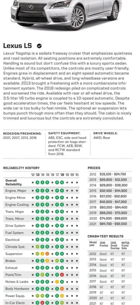

And as others on here have assured, it’s nice to see that reliability has indeed not suffered. Consumer reports has a perfect score for the LS in almost every category
