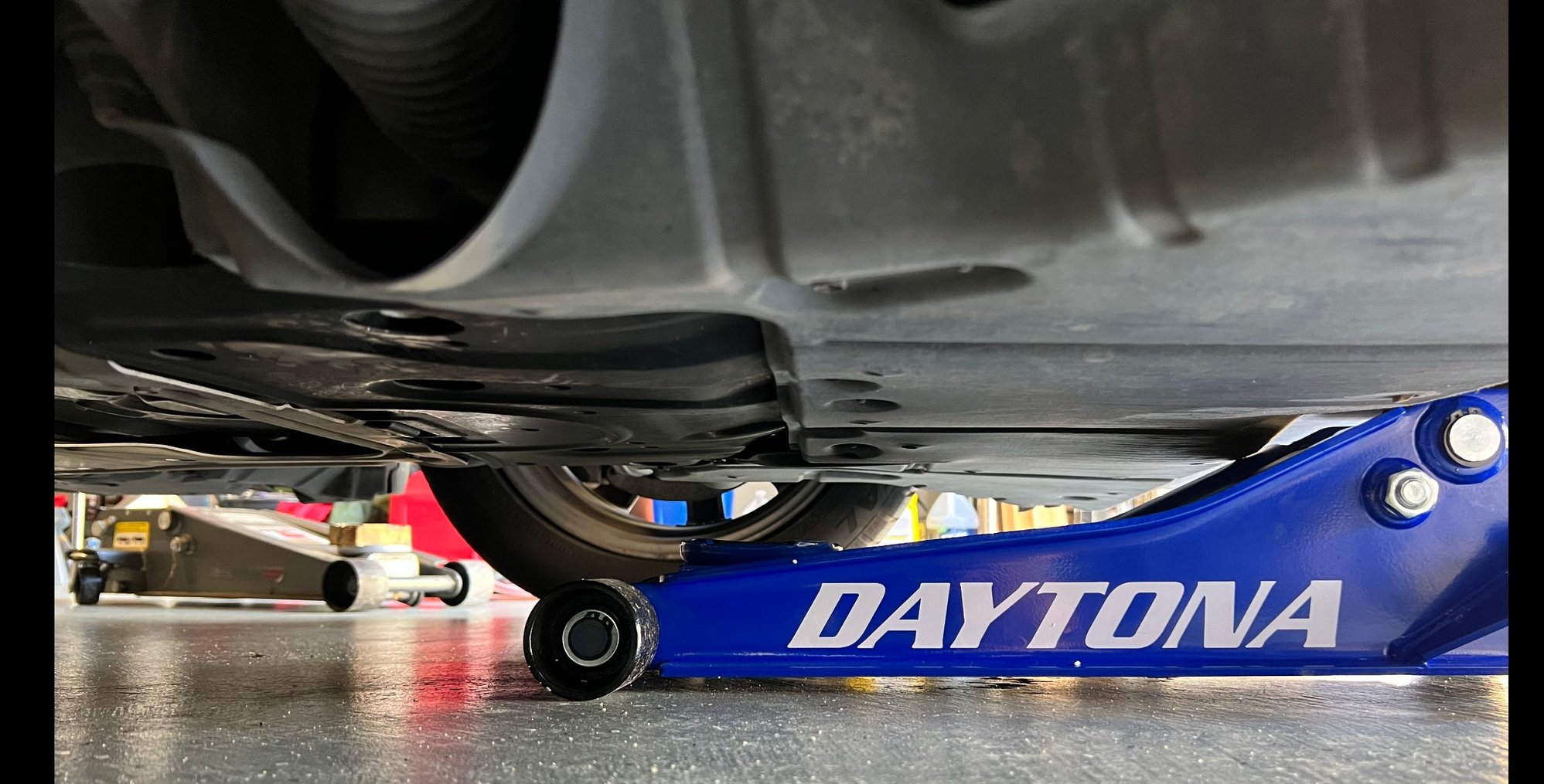

This is how far the 3 ton low profile floor jack is able to reach without raising the LS460. It is couple inches short from reaching the jack point only because of the under carriage cover. It is able to reach the jack point if the LS is without the under carriage cover. The low profile long reach version floor jack has about 3 inches additional reach.
