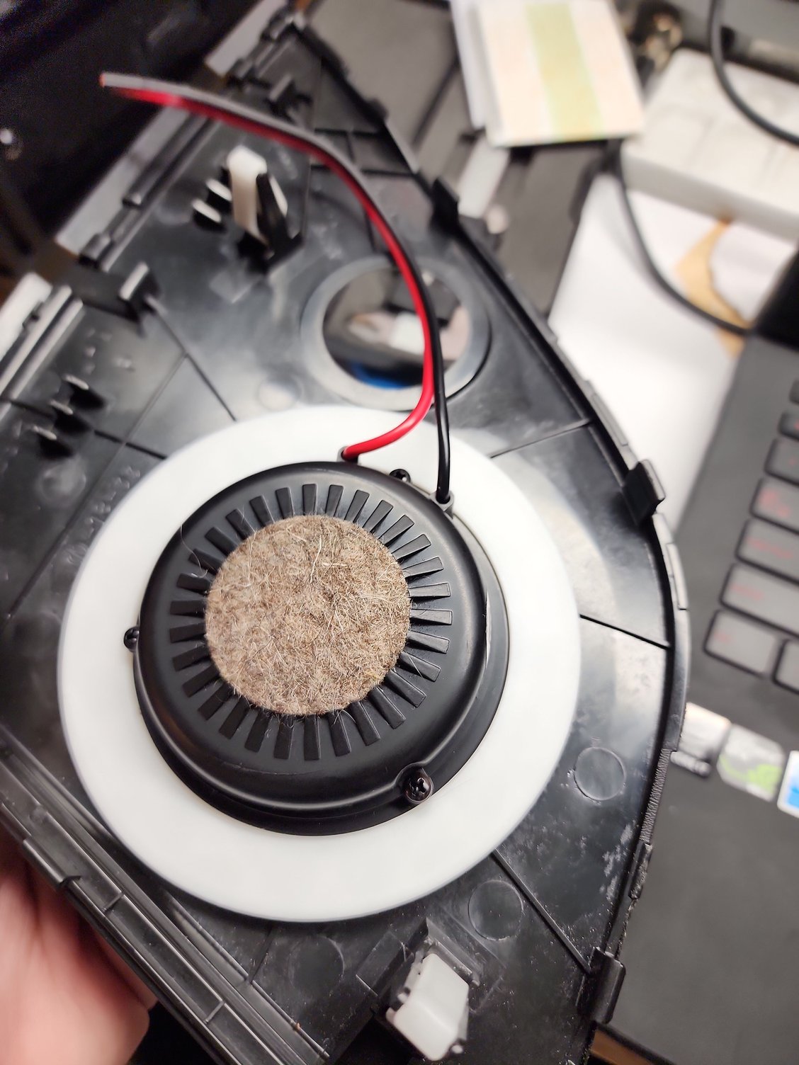

I've had upgraded speakers in the dash for some time but recently one blew so I had to replace it- this gave me the opportunity to mount them better and I got to play with my new 3D printer. Using stock grill covers I got from ebay, I cut out the mounting holes for the tweeter and used the 3d printer to create a mount that I glued into the location for the 3.5, then screwed the new speaker into it.

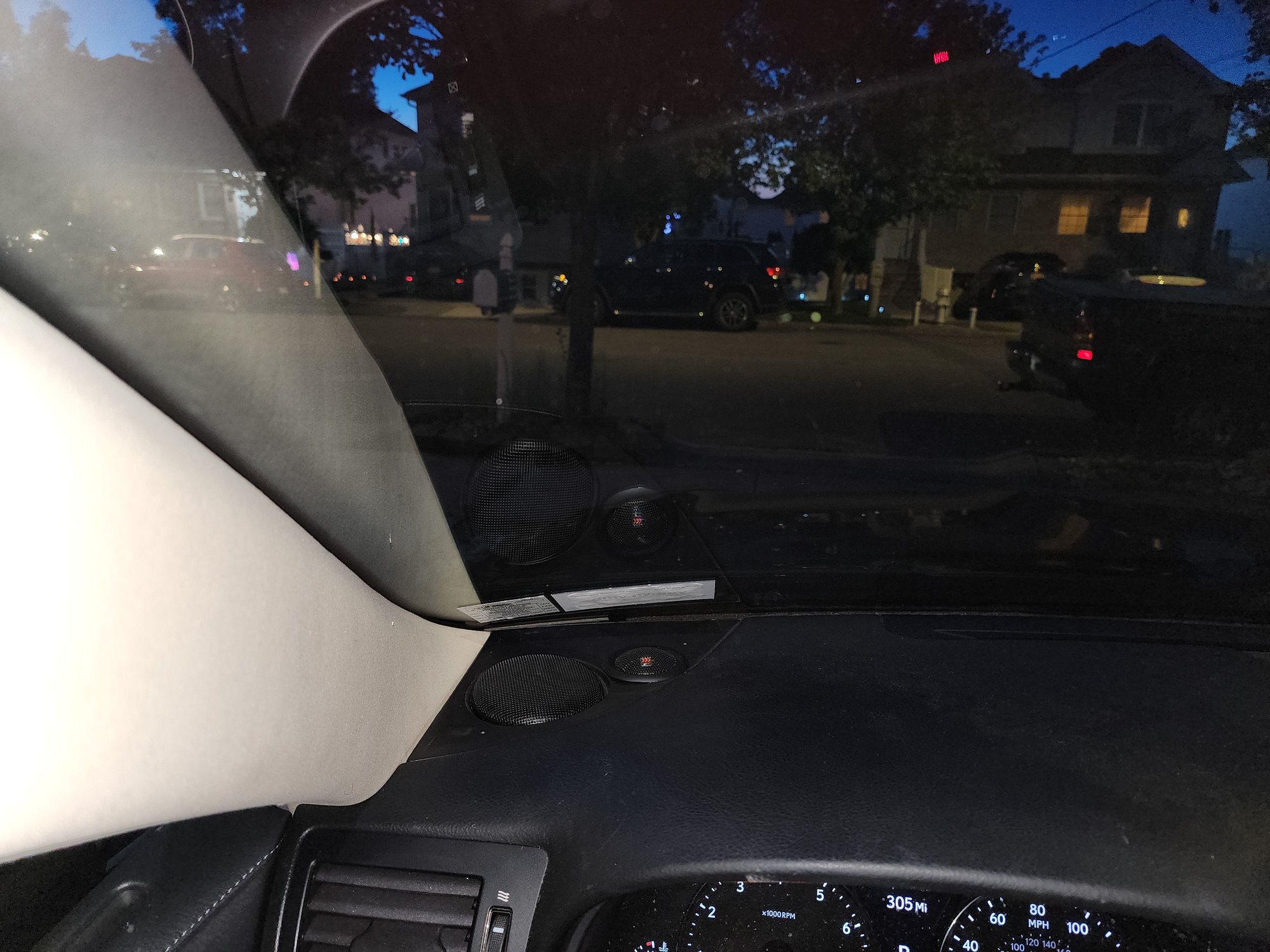

Daytime photos.

LOkks even nicer in daylight. 3d printers are amazing. As is your creativity.

Using a plastic spatula, gently work your way under the most rearward end of the speaker grill covers (the metal.and plastic piece come out as one). There are 2 clips, one front and one back. Once the back unclips, the front will follow as you push up, click, then pull out towards you.
press the spatula (plastic trim removal tool, wrapped screwdriver, basically anything that will not cut or damage the soft materials), gently right around in there and pry up, then out. Reverse to put back in.

This is what the underside looks like, so you have an idea. The clip in the bottom right is the clip closest to you on the car.
