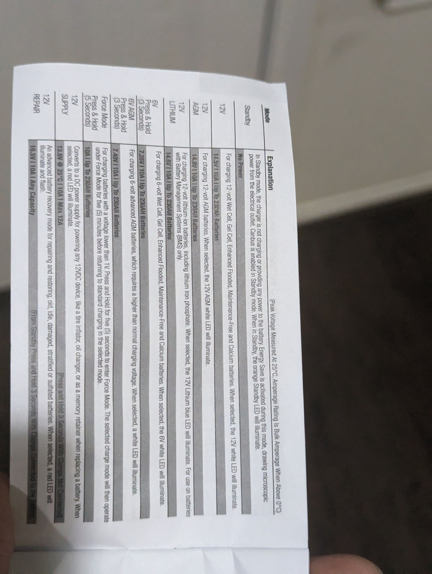

I think NOCO Genius 10 has a dedicated mode for supplying power in absence battery
It's called 12V Supply
