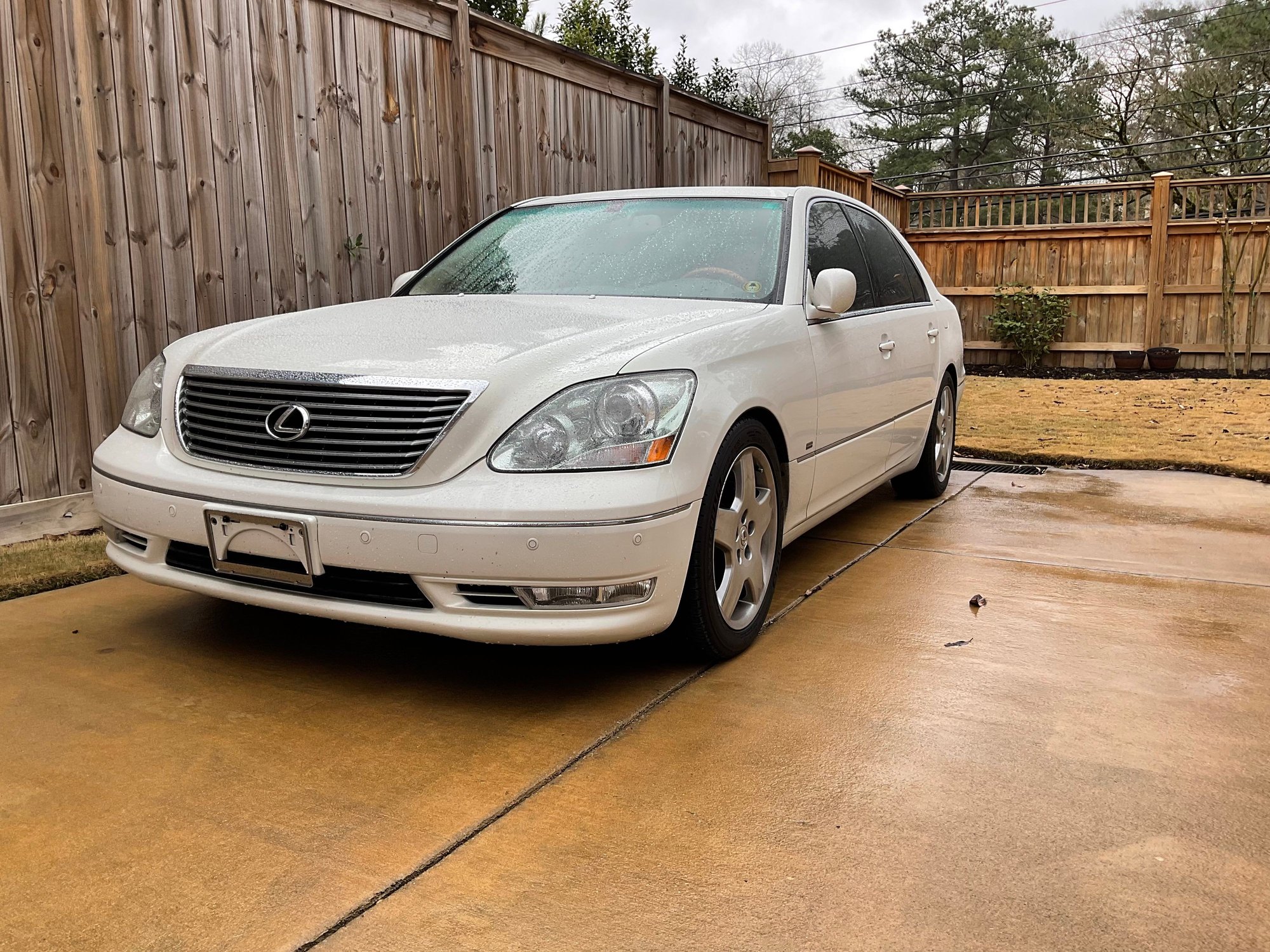

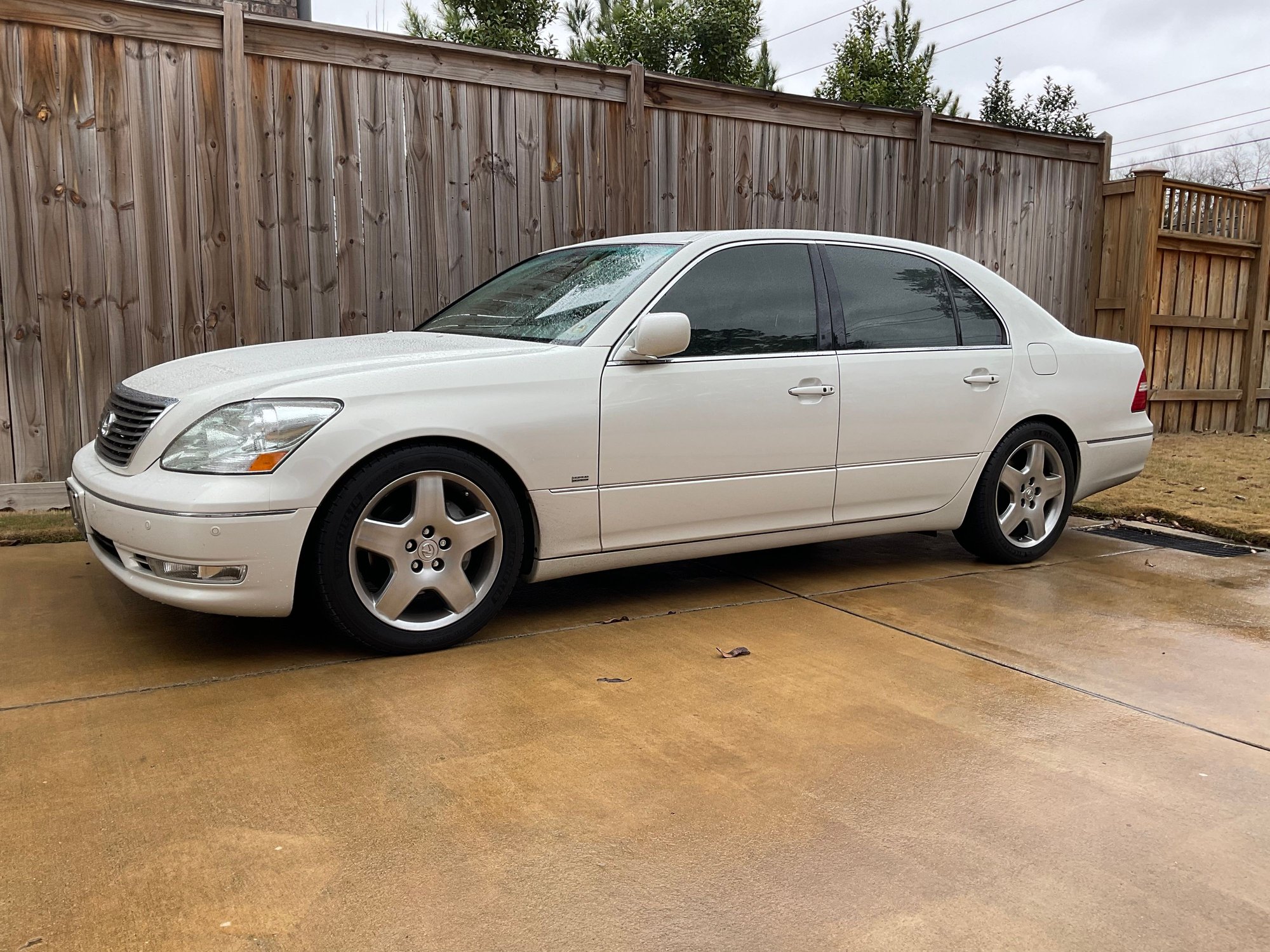

Does anyone have data on weight distribution for an ‘04 ML? Seems like 53% front and 47% rear is what I’m finding, but would like to confirm. Also, is that with an empty gas tank? Lastly, what about side-to-side weight, meaning at each wheel?
I just installed some new coilovers and the car seems to feel a little twitchy. I’m no racer, so could be in my head, but would like to put the car on scales and verify.
Also added spacers, 15mm front and 25MM rears for the right stance.
Thanks

Coils shouldn't make the car more twitchy, more alive and road feel, less body roll. What coils do you have and what hardness setting did you set it to? Alignment looks ok no crazy Camber
