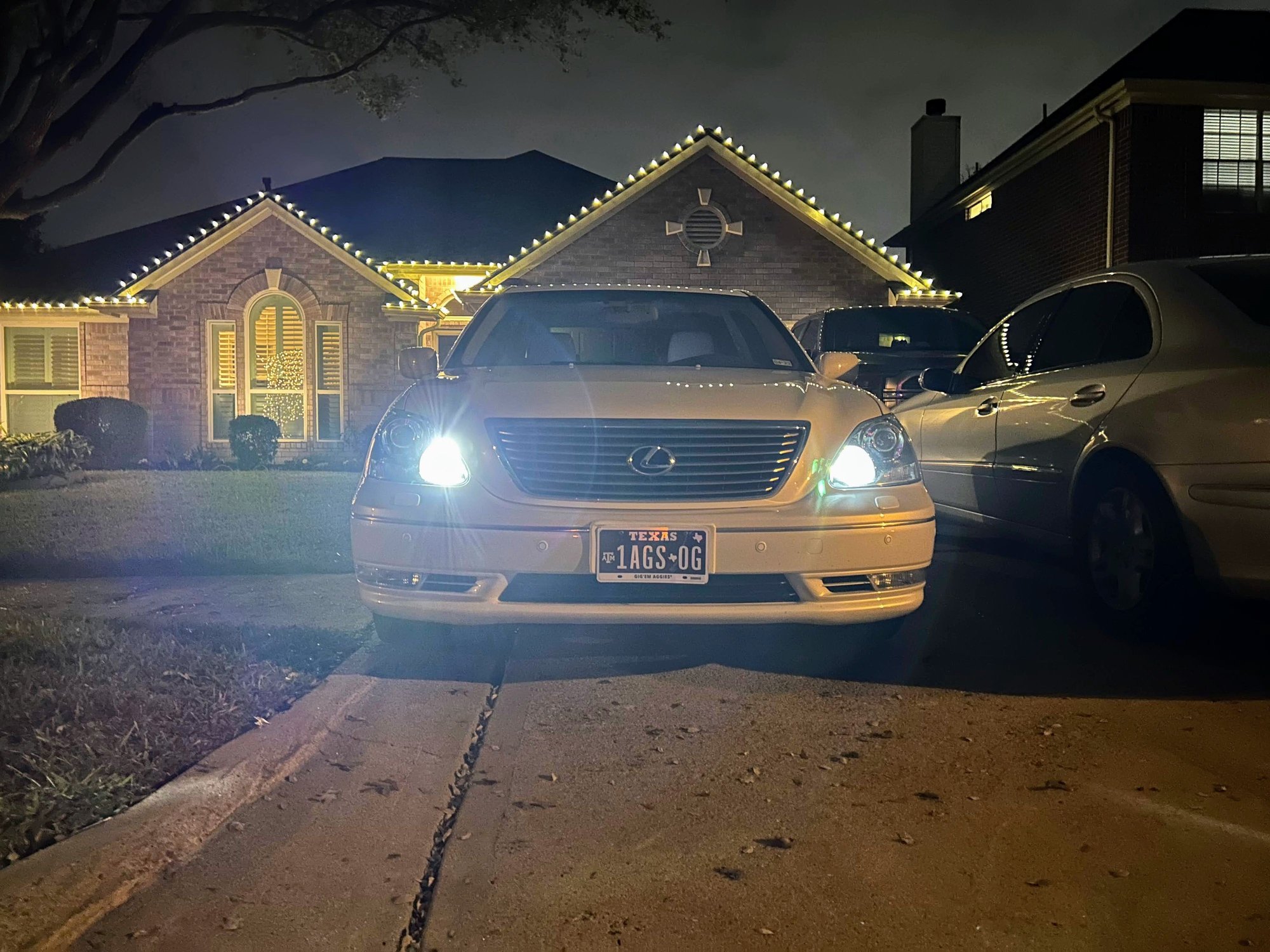

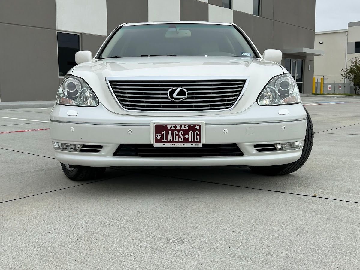

I know this has been discussed in the past over and over, but I thought I'd go ahead and take the plunge and try it out and report back.
I purchased the VLEDS PWM DRL kit, in 5000K.
This is before....
The kit that I purchased:
The kit includes two LED bulbs, the LED driver, a Fuse holder with ring terminal for the battery, and wiring from the fused battery line to each LED driver, and wire loom. The LED driver also has a harness with ring terminals for grounds, and bolts, which can be grounded to unused threaded holes on the fender structure. Pretty convenient.
I won't go over on the details of removing the panels to access the bulbs themselves, as its well documented both on this forum and the youtubes.
I ended up running the 12V line for the driver light in front of the radiator, zip tying along where other wiring is for the horn. The loom protects the wire pretty well and there's plenty of extra slack.
The LED has a fan on the back of them.
Didn't get all the photos, but I ended up using electrical tape to clean up the slack wiring, and then securing it to existing harnesses, and letting the LED resistor as well as the DRL switcher sit on top, so it has air circulation around it.
The end results are fantastic! Zero flicker, a good clean LED DRL, and fantastic high beams! The photos don't do the light justice. I was trying to play with angles but couldn't capture it really well. Overall very happy with the results, and don't have to look at the yellow DRL 'glow' anymore!

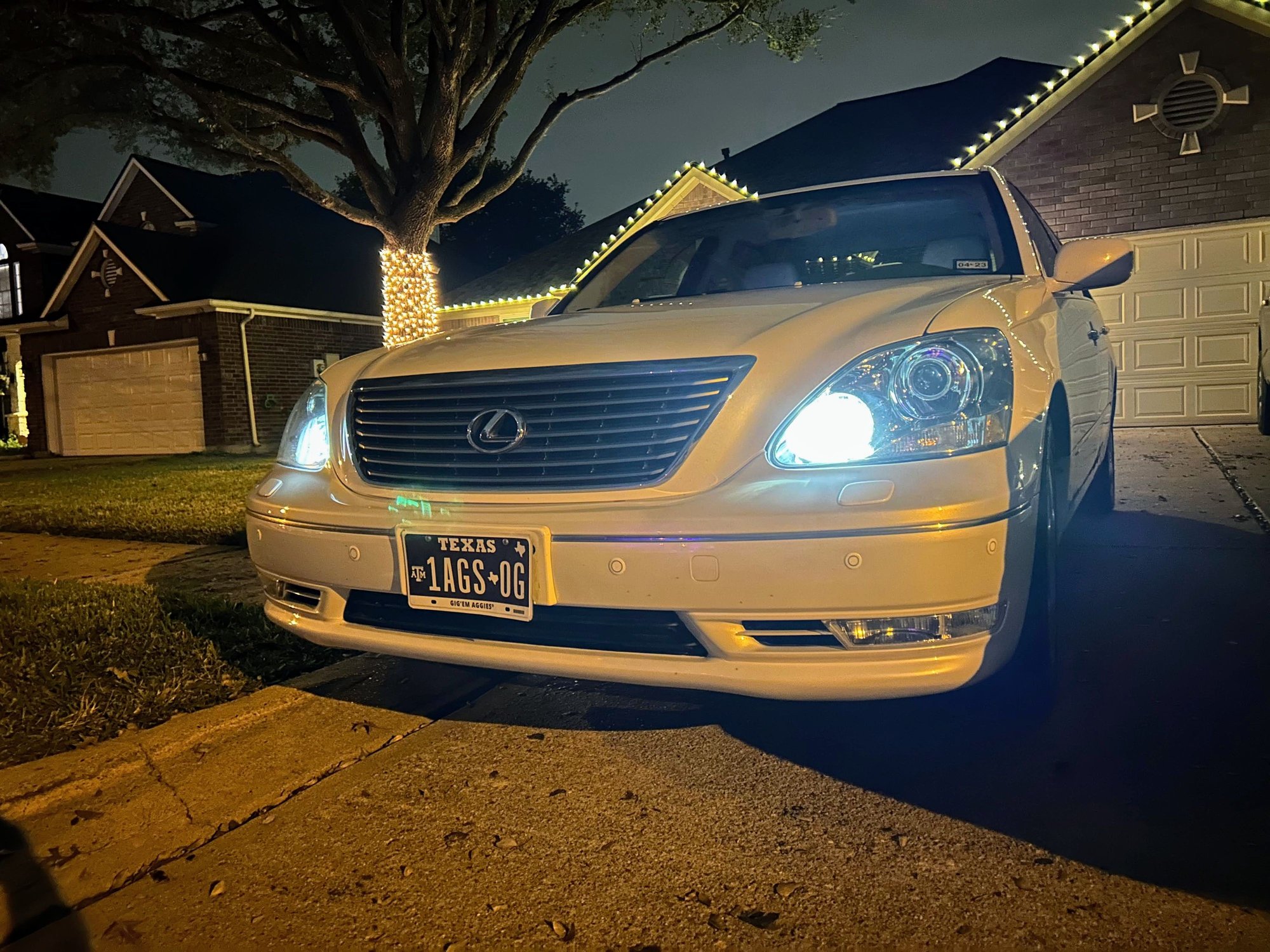

Heres some night shots.
