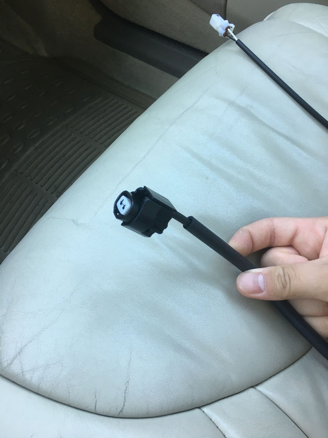

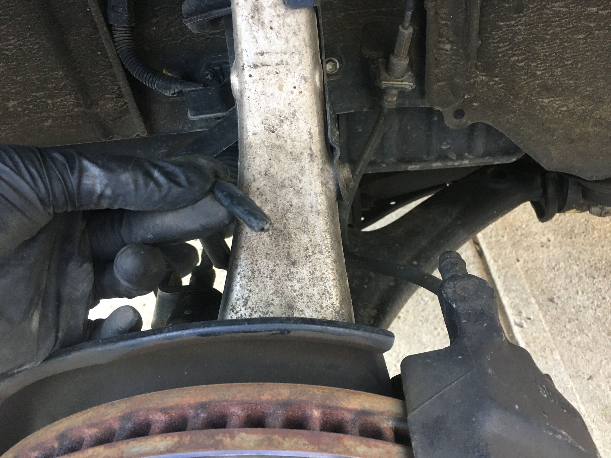

My 430 has had it's first part/system failure that doesn't fall under prior owner failure to maintain or normal wear like bushings. The drivers wheel speed harness wire has sheared off due to the wheel being turned left to right who knows how many times. I find it funny the wire had the failure not the bearing/something that normally goes wrong.....
The replacement part is revised to prevent the same failure from happening by taking the strain off the connector wire.
New style
Easy fix, it's funny how few issues these have

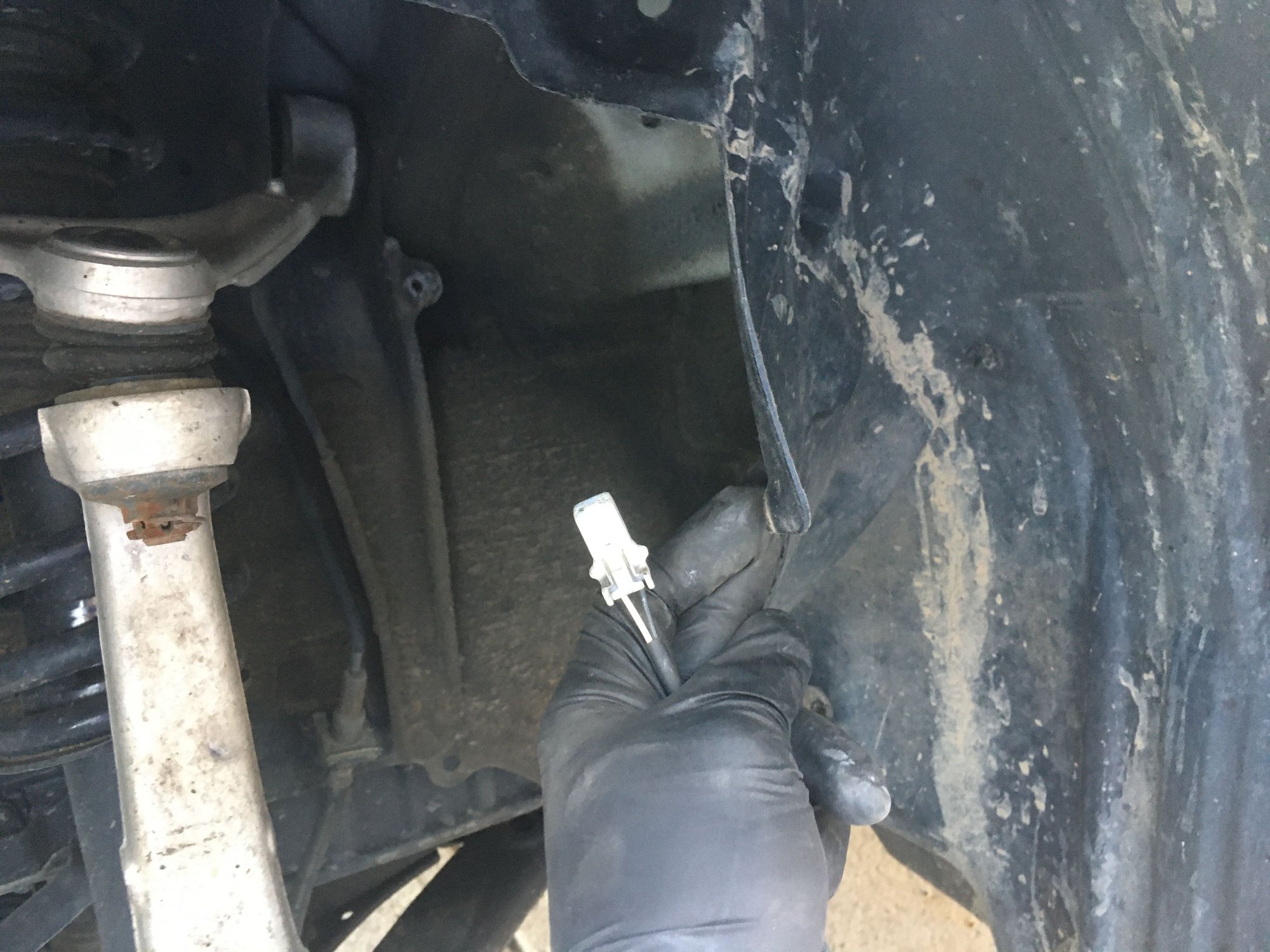

Old connection failure point

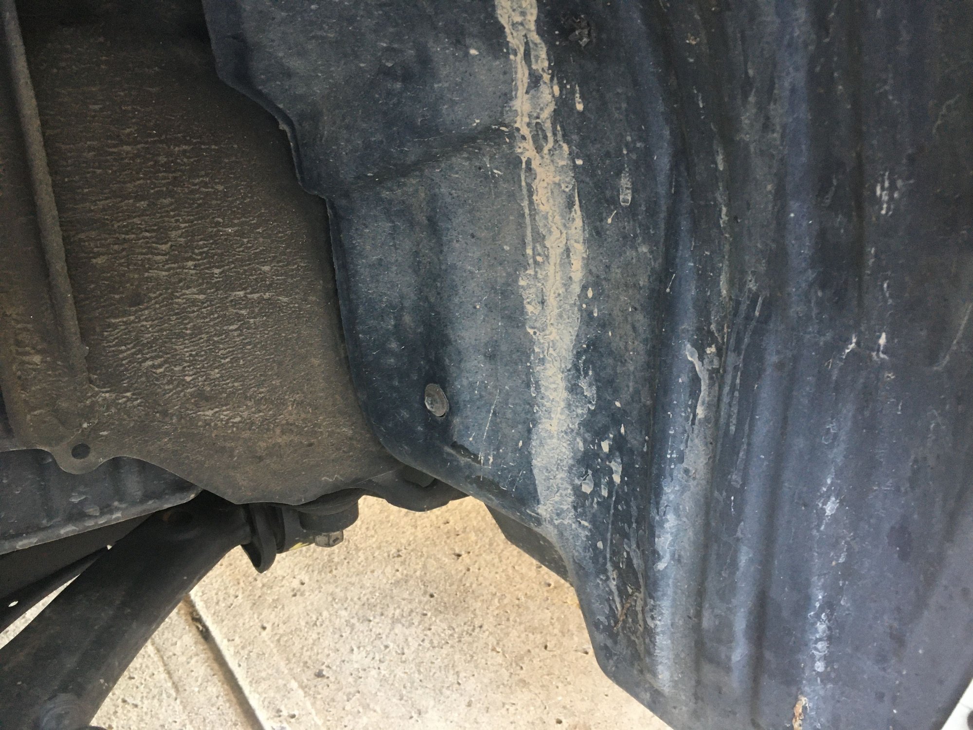

Three bolts

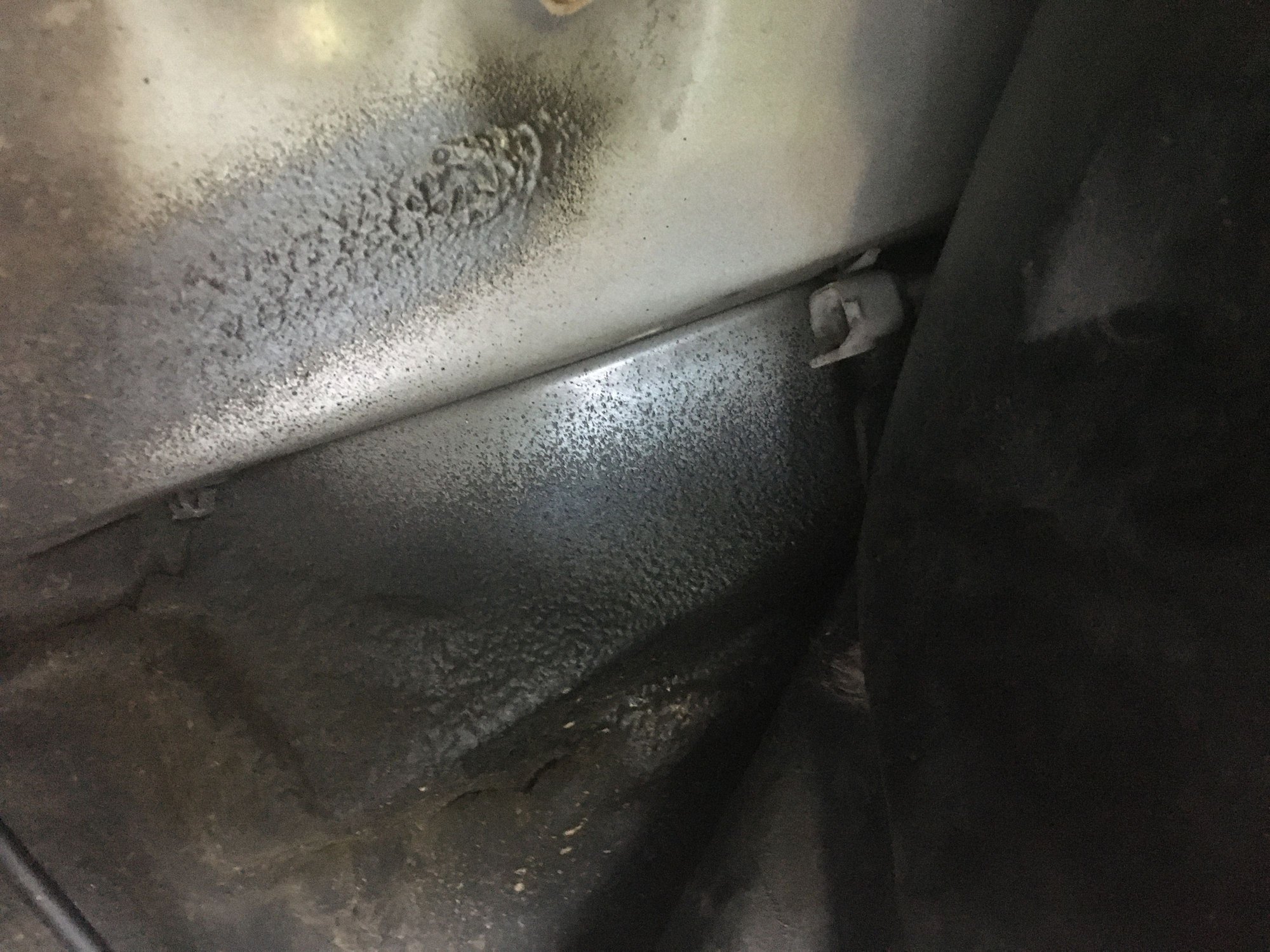

Two on the shield

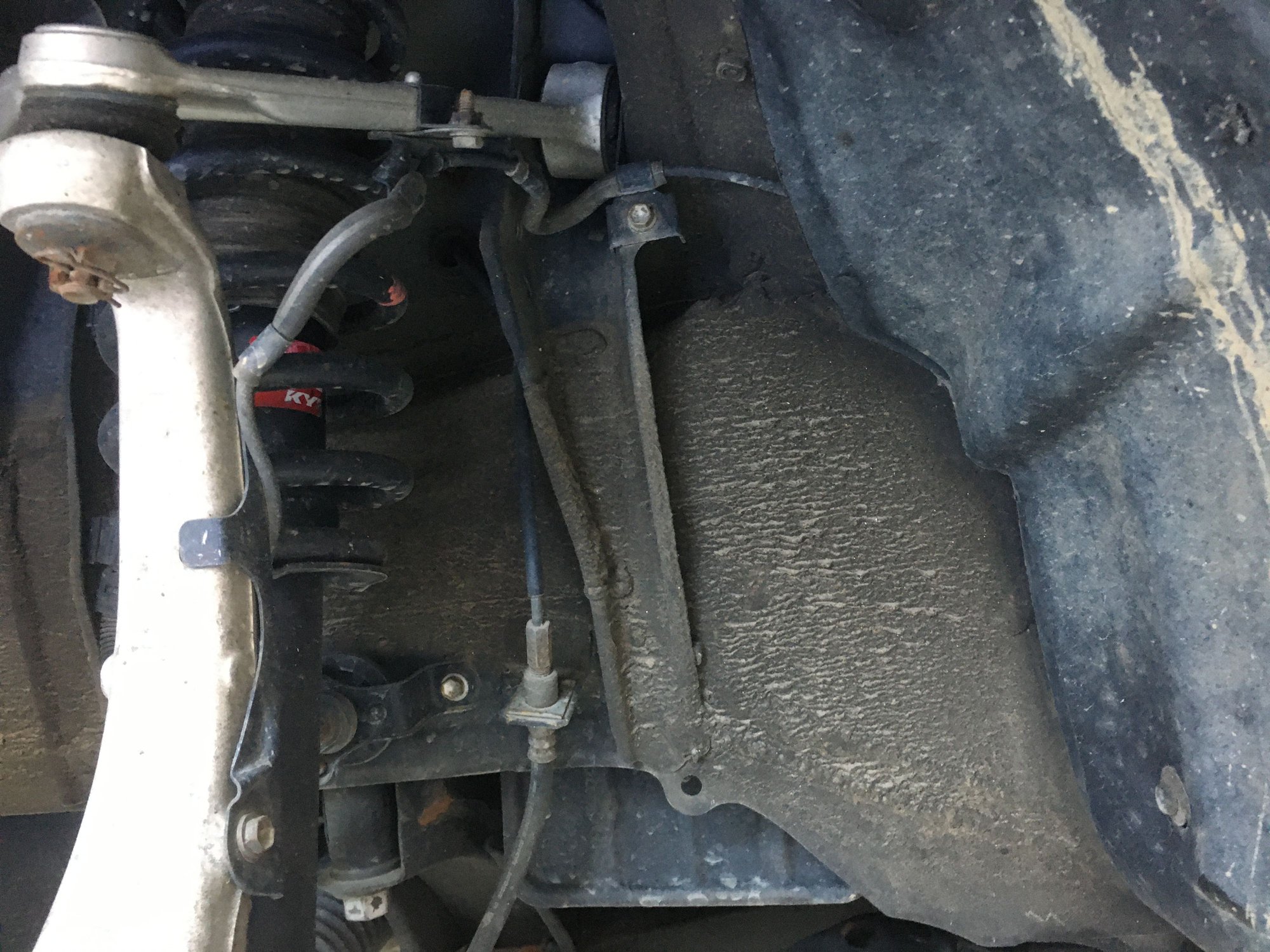

Bend back
There you go
