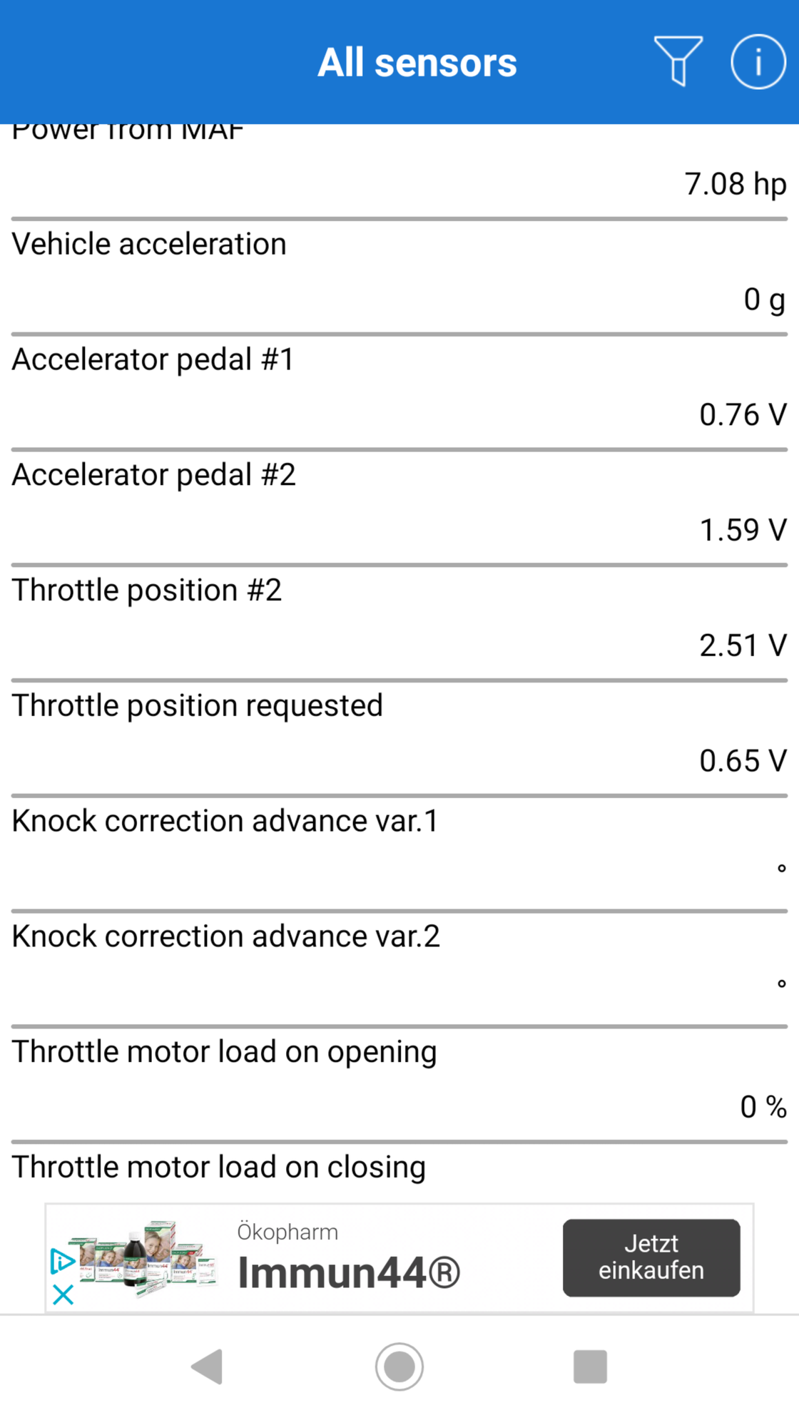

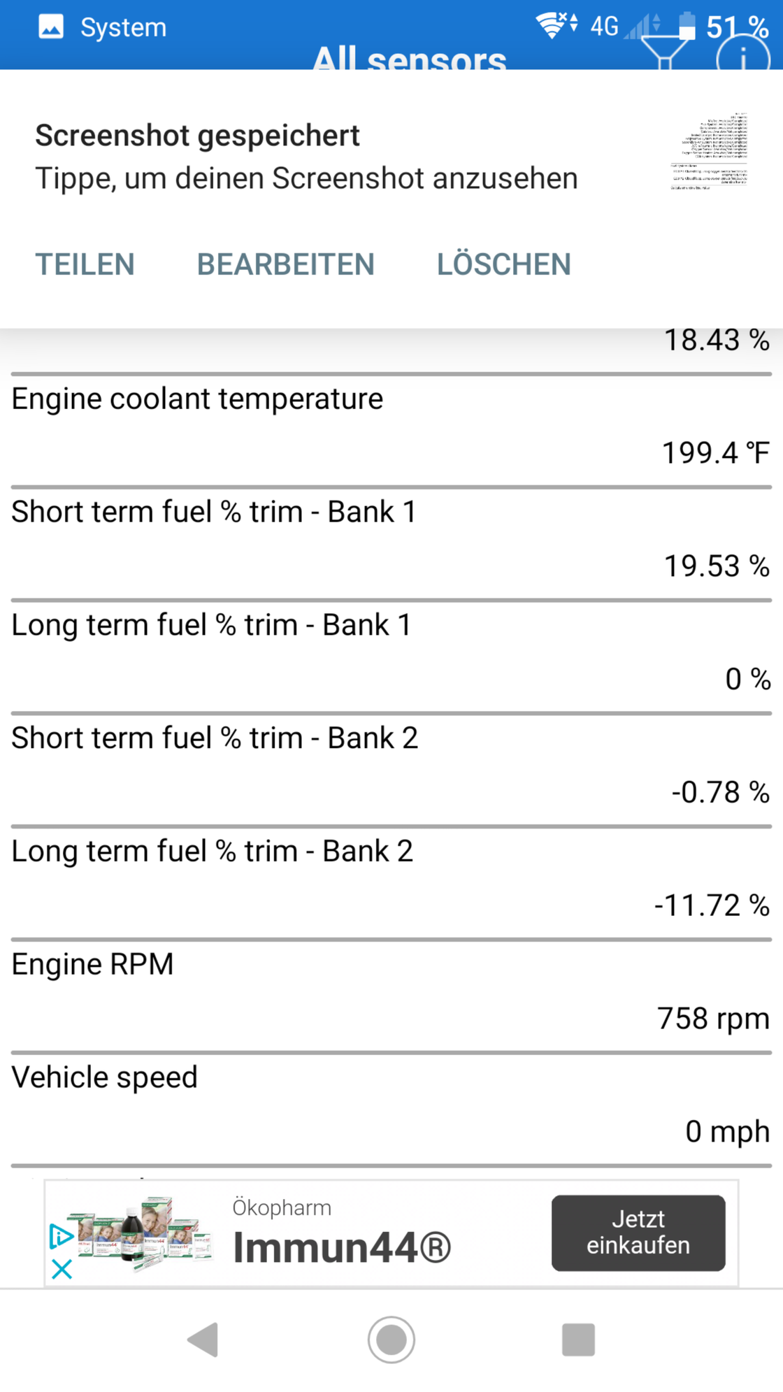

Then I looked at the read outs the app gave me while idling, the engine was warm.
I took a couple of screenshots and will upload them here. Maybe you can take a look at them and tell me if there is something that is not right.

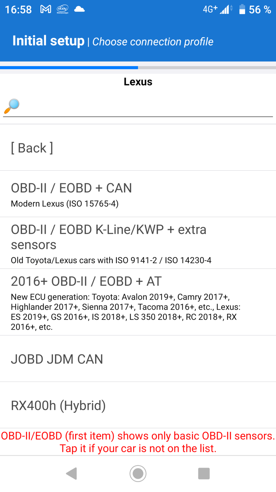

And I pressume you chose the profile for 'old lexus/toyotas' ? In settings there are connection configuration - I had most success leaving it to automatic. The scanner will work through settings to make the best connection - be prepared for this to take 5-10 minutes (with the engine running).

Your bank 1 sensor 1 is bad. It should never display 0v. Your ecm is adding almost 20% extra fuel based on the incorrect readings. Running this rich will very quickly destroy your catalytic converter on that side.

Your bank 1 sensor 1 is bad. It should never display 0v.​​​​​​
Too early to condemn the sensor yet without other contextual data.
It's only showing 0v in one of the screens. In the other two screens it is showing voltage. (admittedly not much).
Certainly worth investigating further but too early just to pull and replace..

@911LE did you see that in my screenshots, that I am using too much fuel? The car has only one cathalitic converter for both sides - thats what I read somewhere.
I checked the scanner app again and this time I was able to download the recorded driving session from yesterday.
I made a couple of screenshots again and will add them to this post. Bank1 Sensor 1 seems to do a lot less than Sensor 1 on Bank two?
The chart LTFT means Long term fuel % trim - Bank 1 and Bank 2 - also here Bank 1 is not doing much!!
What do you think? Do you need any other parameters from the drive yesterday as a screenshot to pinpoint the problem?

Yep that o2 sensor 1 on bank 1 is definitly caput.
Strange it's not throwing a o2 sensor code.
It's often wise to replace both sides as a pair at the same time.
