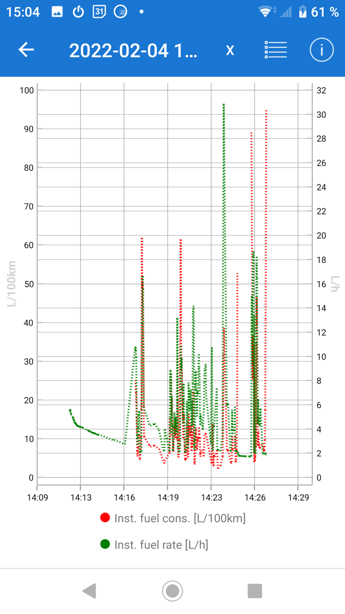

Another thing you can do as well for viewing the trip data after is view sensor on their own charts and have many at once shown or you get them on the same chart as you have found.
A good thing I'f putting on a combined chart is to use similar range sensors. See in the chart below, the economizer on goes between 0 an 1. It looks flat compared to temperature which is- 20 to +200 ramge So it is better paired with a sensor readin of a smaller range or on its own

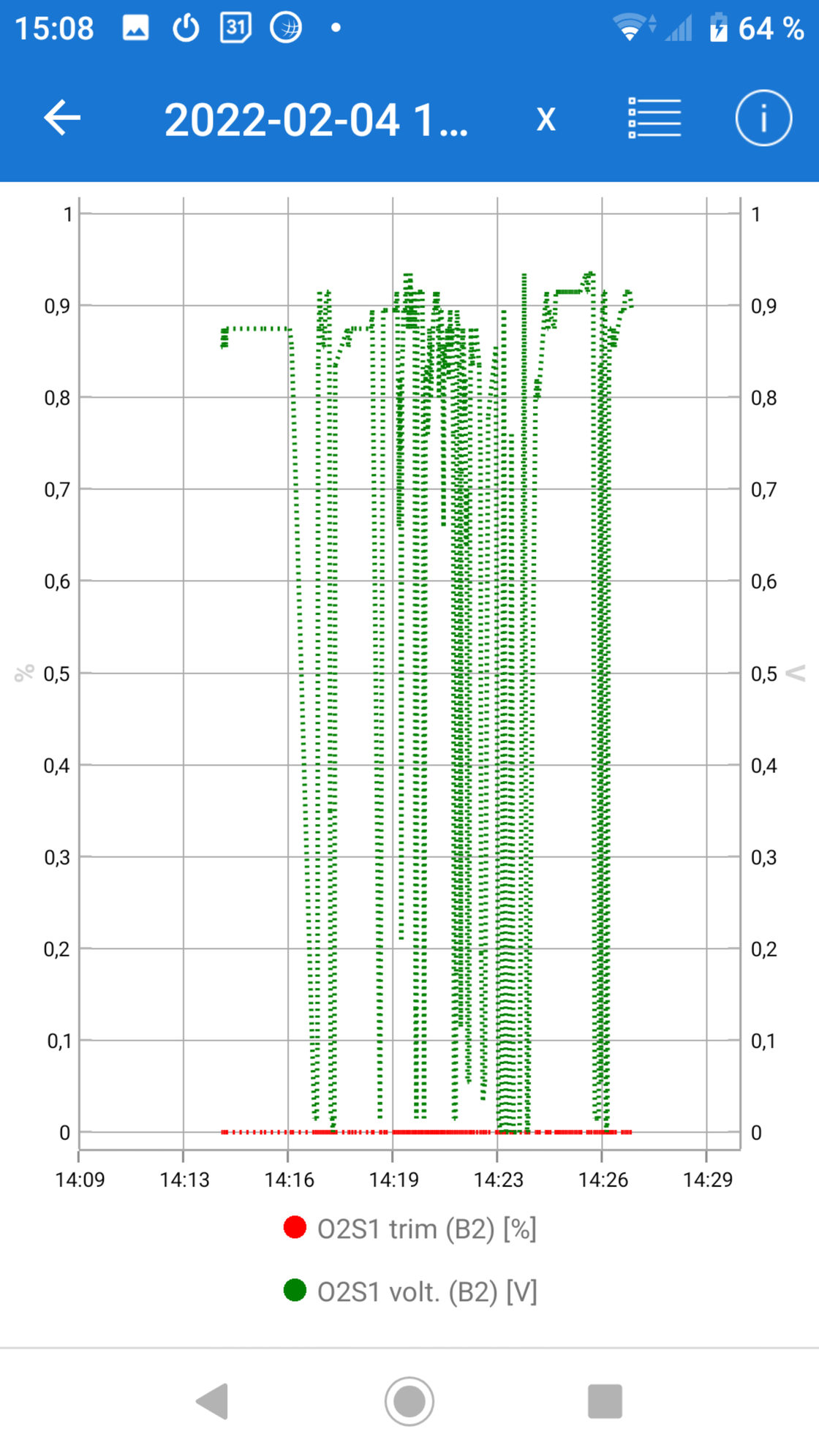

Ok, I did one more reading today, just focosing on the long term fuel % trim Bank 1 and Bank 2
95% of the time B1 did not do anything. But on some incidents it did work. Should it not either be broken or not broken? How can it sometimes work?
Also Bank 2 did work most of the time, but there were short intervals in between where it also stayed on level 0 - so is it also broken? Also if it works for most of the time?
Or does this mean, that there might be a different problem somewhere? Here are the 5 screenshots of the same chart, where I thought it was very odd.
Especially the last one is strange.
