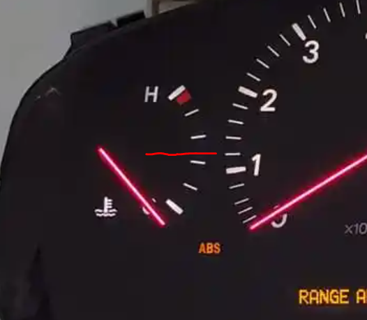

Is the temp gauge right below the half mark once the engine is fully warmed up?

Hi, thank you for the quick reply.
Here is a screenshot from a gauge in the internet,
i drew a read line where the needle is at, once the car is warm.
It is always above the white line, which is just below the middle.
