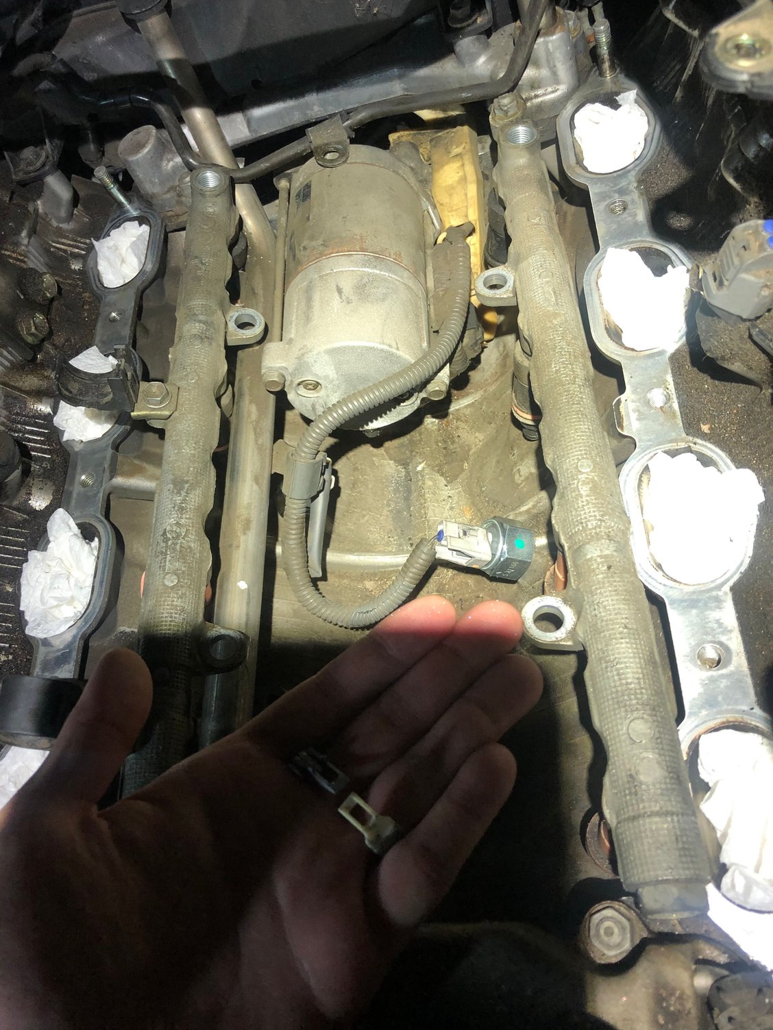

Made more progress! Thank you for the damper idea!! I had to also take the stupid fuel rails and injectors off due to so much crud that buried the nuts and bolts for the lower intake manifold. I got the knock sensors swapped and of course, the plastic locks broke off. Original starter still going strong at 217k miles for a 2003. Got some metric flex head wrenches coming tmr to do the starter, will swap it since I’m here. Keep the original for an emergency spare I guess.

I’m not sure what to do for the broken knock sensor connectors. Is there a part number for those. I’ve read online it’s part of the starter wiring engine harness which is pricey.
I’m thinking about just a dab of super glue or a dab of JB weld?

That will work. You likely won't need to go in again.

Yep jb the connectors will work.

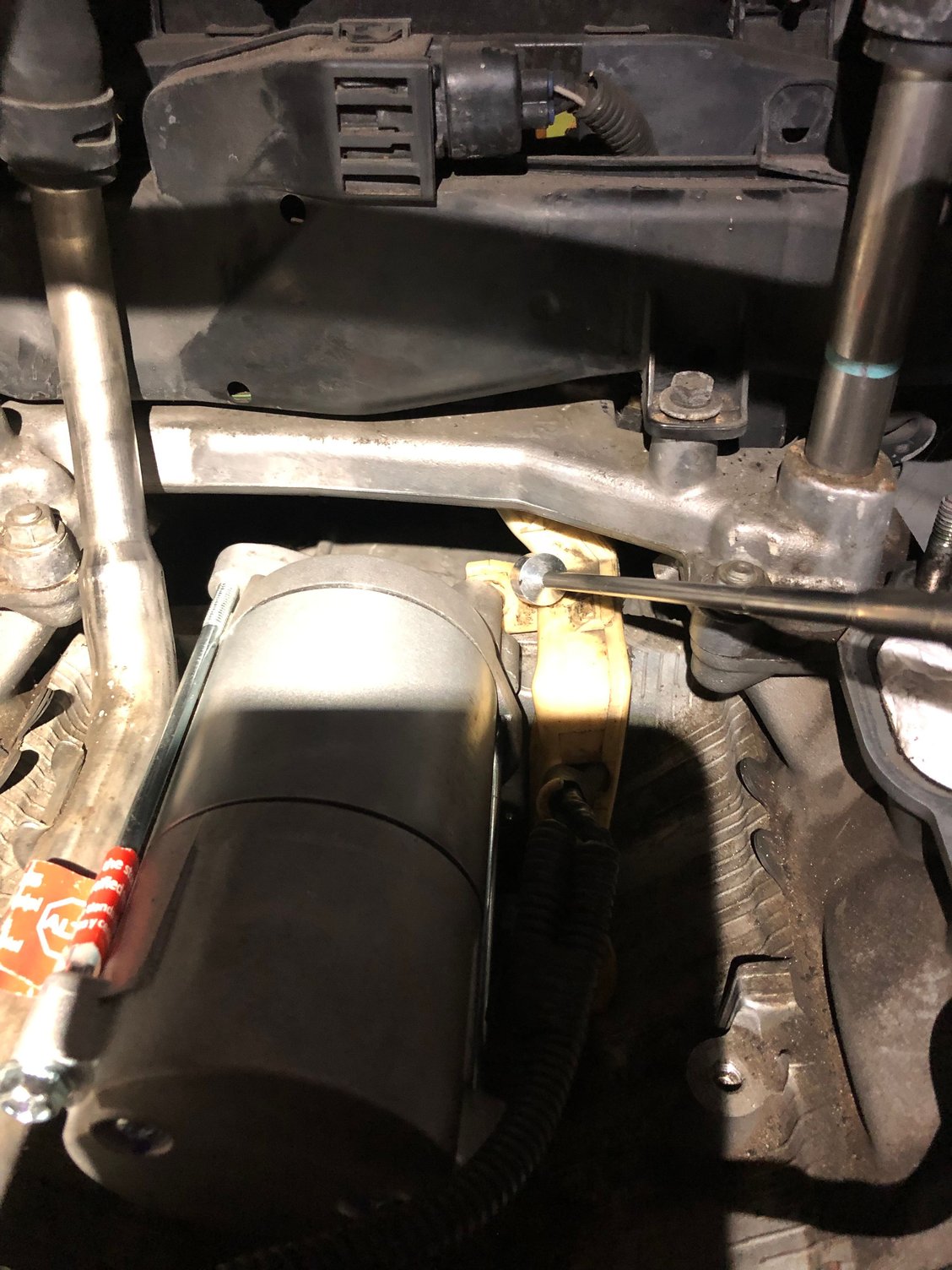

Just want to make sure. I got the new starter mounted, the x2 14mm bolts. That 3rd bolt that’s a 12mm, that holds the yellow plastic bracket… that just holds it right? Bc I lost that stupid thing. Doesn’t look like another grounding because the actual ground is on the right side body. Just triple checking and wanna out everything back together. Hope it’s not a 2nd ground….Thx!
