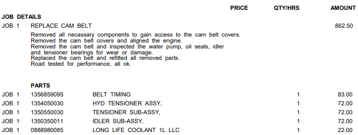

timing belt service
Here's the details of the service invoice, maybe the water pump was included automatically.
Old Jan 30, 2021 | 02:57 PM
ChopsGS's Avatar
ChopsGS
Joined: Jun 2019
Posts: 153
Likes: 54
Doesn't look like it.
