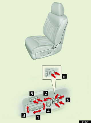

1-3. Adjustable components
Front seats
Adjust the seat positions using the switches.
1. Seat position fore/aft control switch
For driver’s seat only:
Height of the head restraint also moves upward or downward with the seat movements.
2. Seatback angle control switch
3. Seat cushion (front) angle control switch
4. Vertical height adjust switch
5. Seat cushion length control switch (driver’s seat only)
6. Lumbar support switch
Adjusting the front passenger’s seat from the driver’s seat
1. Seatback angle
2. Seat position

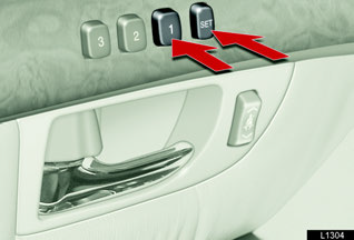

Driving position memory system
The vehicle will memorize the position of the driver’s seat, the height of the head restraint of the driver’s seat, the seat cushion length of the driver’s seat, the height of the shoulder belt anchor of the driver’s seat belt, and the positions of the tilt and telescopic steering column and outside rear view mirrors. Three different driving position profiles can be entered into the computer’s memory.
■Setting the driving position
1. With the transmission selector lever in the “P” position, turn the ignition switch to the ON position.
2. Adjust the driver’s seat, driver’s head restraint height and seat cushion length, driver’s shoulder belt anchor, tilt and telescopic steering and outside rear view mirrors to the desired positions.
3. While pushing the “SET” button, push button “1”, “2” or “3” until the signal beeps.
By repeating these three steps and pressing the other button, the driving position for another driver can be recorded.
Recalling the memorized position
The driving position will be automatically adjusted to the position recorded for that button when:
•The transmission selector lever is in the “P” position.
•The ignition switch is in the “ON” position.
•Pushing button “1”, “2” or “3”.
