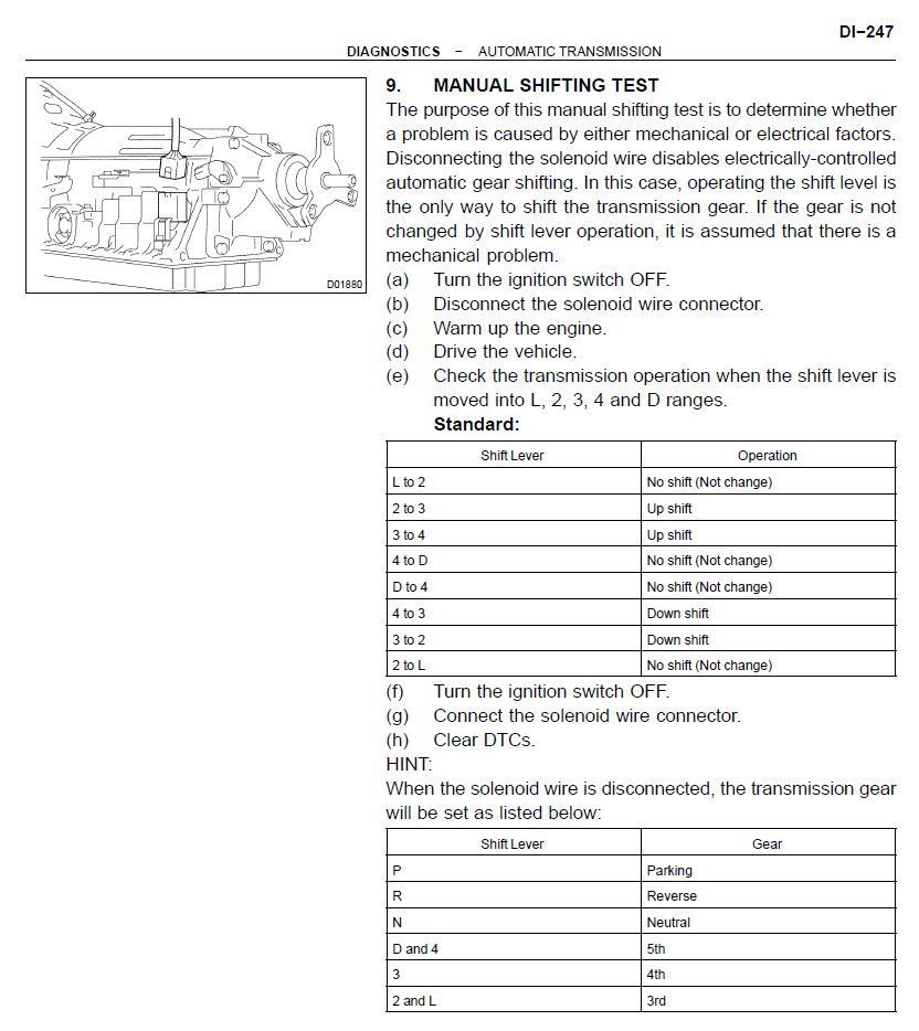

You mentioned that you replaced both Vehicle Speed Sensors (VSS) and that one of the connectors maybe damaged. Please give the "Manual Shifting Test" procedure below a try to determine if you're dealing with a mechanical or electrical problem.
