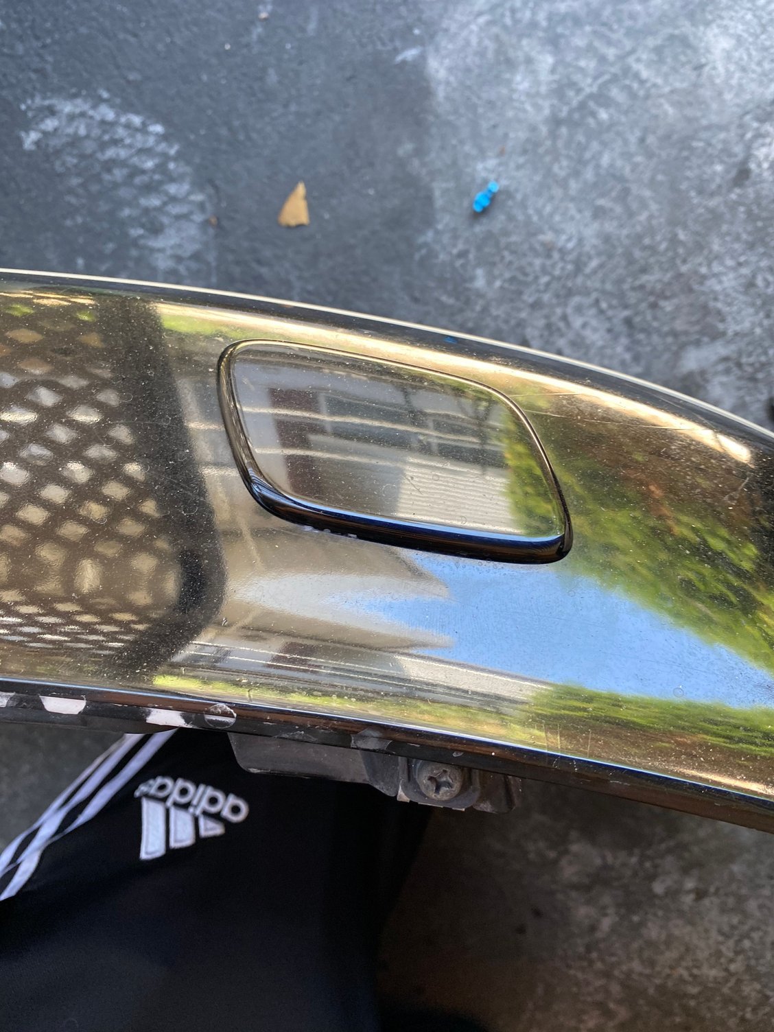

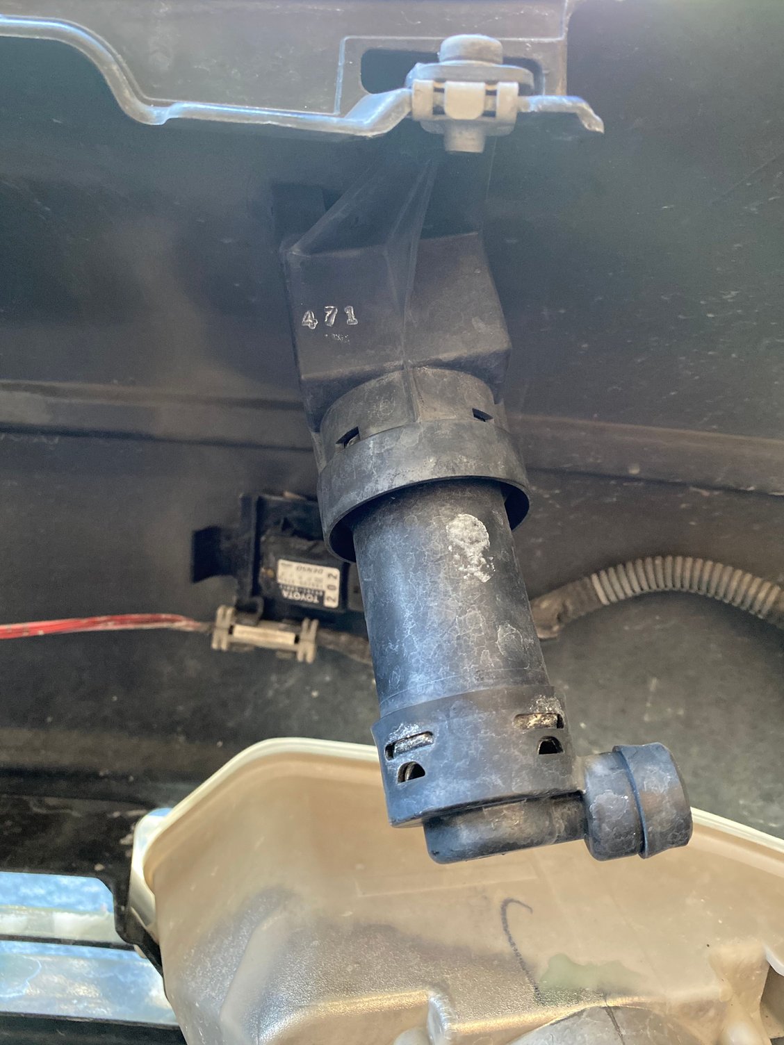

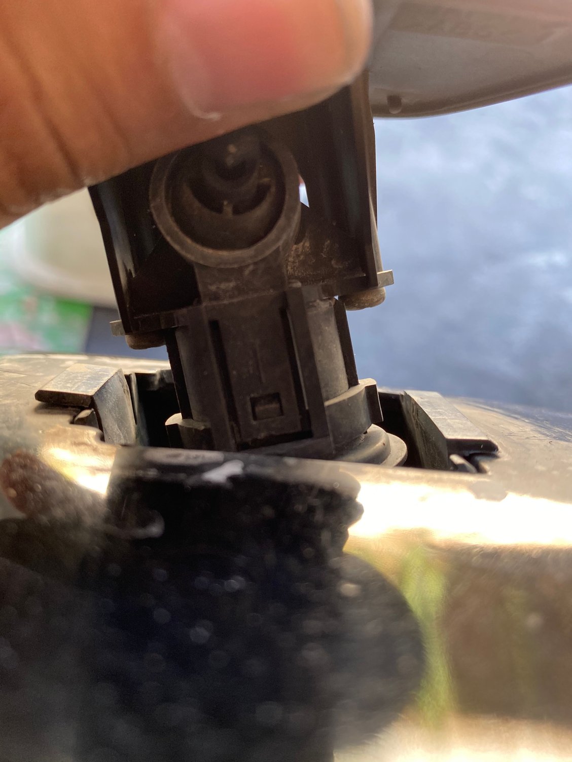

How would I go about removing this I see 2 Phillips screw but don’t know how I would get to it thanks for your time
2 Phillips screws on each side
Plastic bracket it’s attached to the bumper making it the 3rd Phillips screw

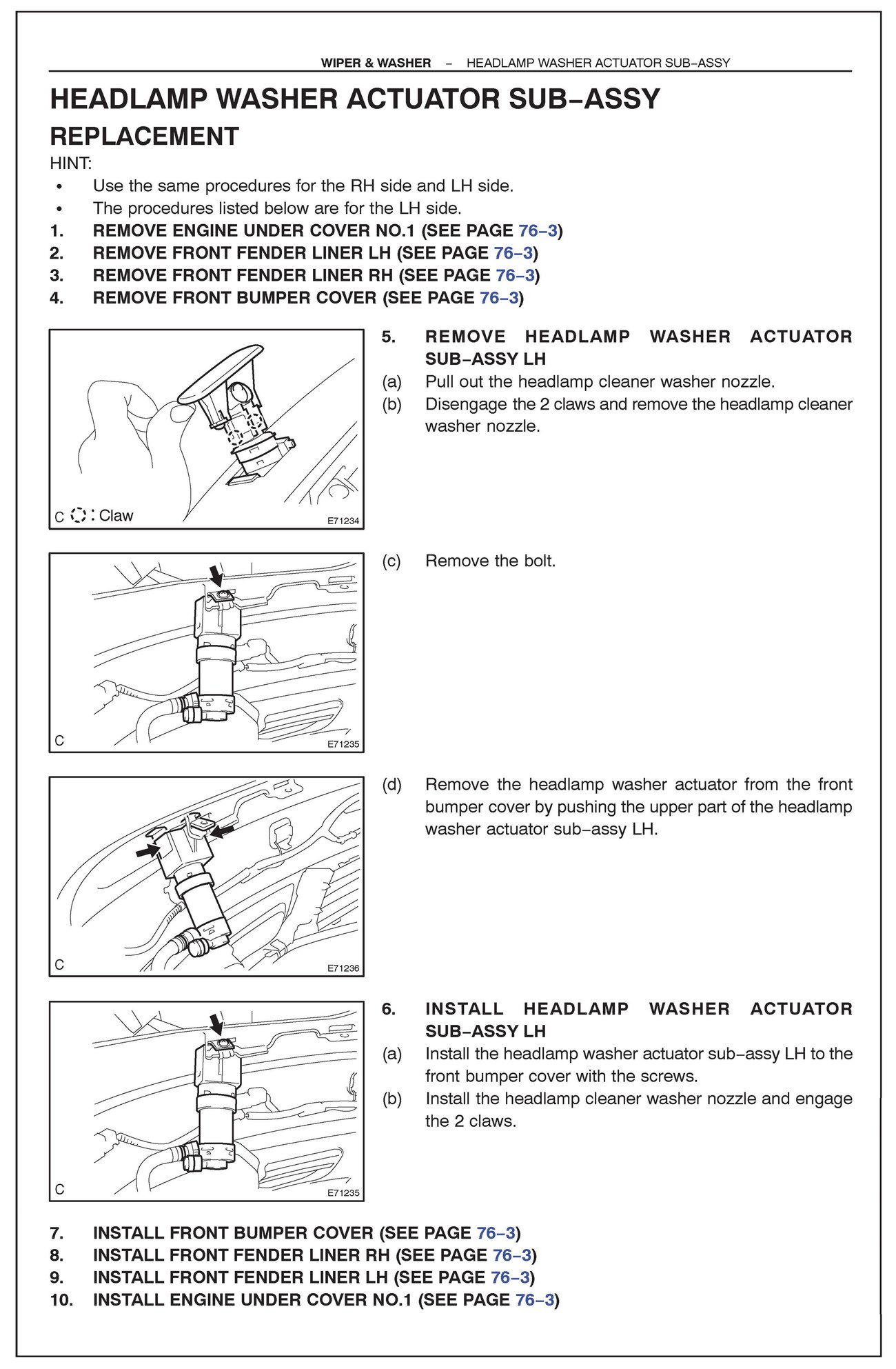

Does this help?

Thank you rk blessed
