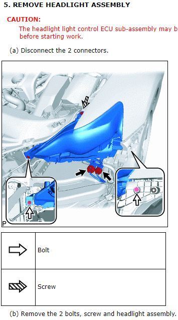

Anyone have instructions on removing the headlight? I know the bumper has to come off and it seemed like a much involved job.

Do you instructions on the bumper and headlight, or just the headlight?
The headlight only has 3 screws that hold it on...getting the bumper off is the hard part...but really not that hard.

Thanks a lot for this. I have to remove the bumper as well. If you have instructions on that i’d really appreciate it.
Better than instructions...a video (courtesy of member @specONE ):
