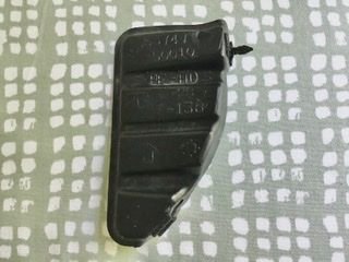

Yesterday my mechanic had the car up on the lift looking for my mysterious rattle. He didn't think it was the break cable but a loose heat shield. He took the heat shield off that is between the front wheels in the center of the car and this item fell to the floor. Its a cover of sorts part number 53747-50010 called a "Right Air Seal". He didn't know where to reinstall it as nothing was visible. Does anyone know what its for and where it goes?

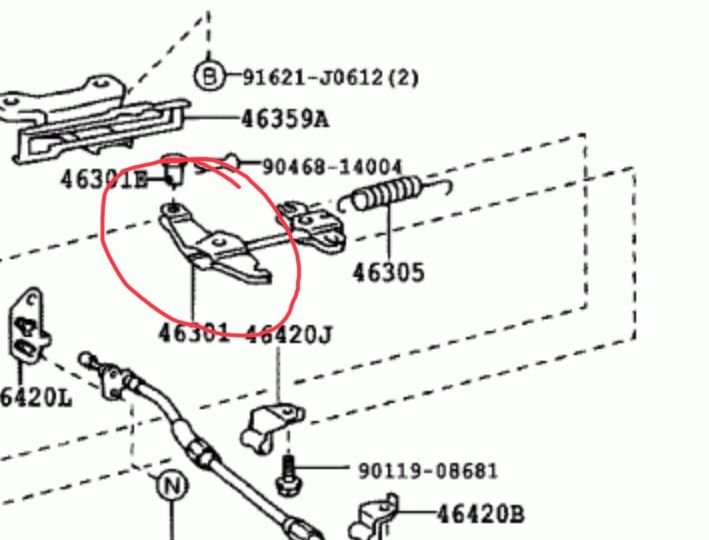

I had a local Japanese car mechanic put the car up on the lift today. He took the heat shield off over the drive shaft (under the center console) and this exposed the parking brake linkage. Their is a slot that the linkage slides in. The mechanic said the slot was wider than it should have been. He tapped on it until the gap was just wide enough for the mechanism to slide but not binding. He loaded on some high temp grease and put back the heat shield.
i took for a test drive over a bumpy road and heard nothing but silence!
The mechanic told me that LS430's are noted for damage to parking brake assembly due to depressing the parking brake peddle with too much force. He thinks that this action could have caused the slot to widen and in turn cause the rattle.
This may or may not be the cause but at any rate I'm satisfied.

Circled is the part that the mechanic Tapped on to stop my rattle.

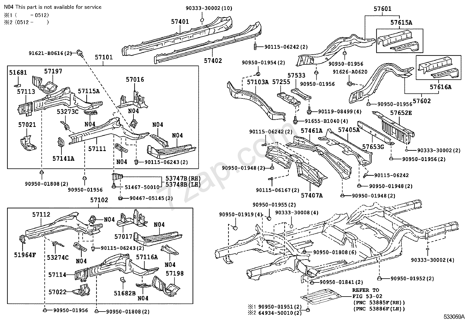

Sorry for replying this rather old post but it’s the only one that related to 53747-50010 part. I also found this piece fallen on my ls430, did you put it back? Where is it locate to be exact? The diagram below really doesn’t help a lot🥲
Thanks!
