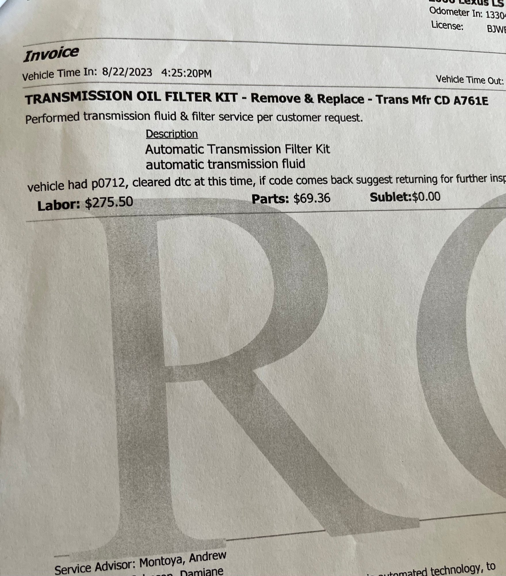

I’m not 100% positive I had it done at a shop.

Find out what code got stored when the check engine light came on and see if it is the same as what is listed on the invoice for the fluid change (P0712).
P0712 Lexus Code - Transmission Fluid Temperature Sensor 'A' Low Input. If it is, you need to address why that code keeps coming back...

Unless the service was done at Toyota or Lexus, they probably didnt use the correct type of fluid (WS). this car (w/ the 6 speed trans) is very specific about the type of fluid needed in the transmission

$69.00 does not seem correct for WS fluid and filters. Should be a lot more. Replacing the fluid in the six speed transmission is very specific.
