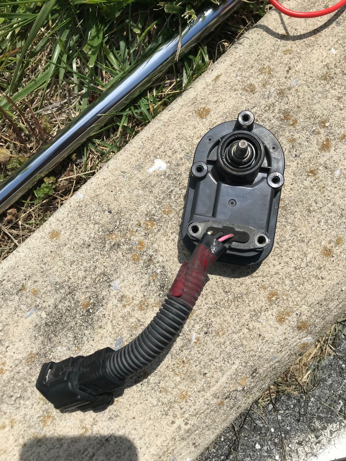

Yup just as was predicted here the AFS started to flash again.
took apart the front sensor this time only to find that I can not open it. The screws do not seem to hold it closed and the plastic cover encases the sensor body.
anyone know how to open this front sensor?

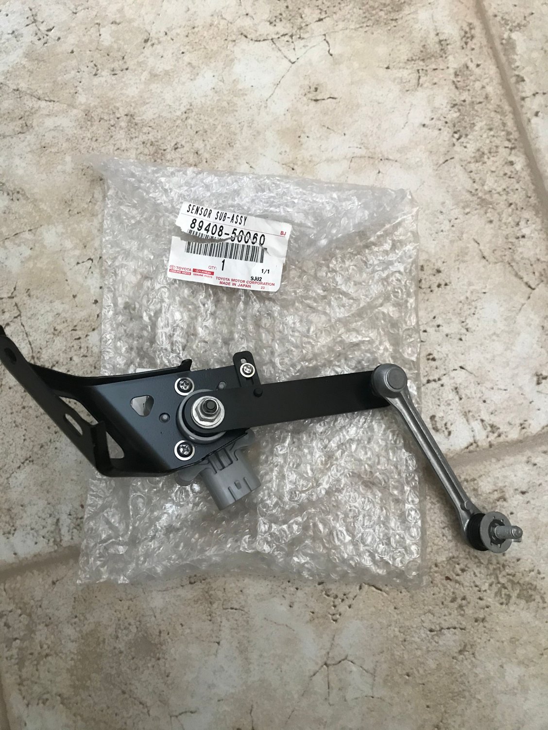

Default Fixed it!!!
I am happy to report I fixed my blinking AFS light.
First I took apart the driver rear sensor. opened up the sensor housing to take a look at the springs inside and all three springs were in pristine condition and corrosion free. The brackets were in good shape and nothing seemed to be broken. Although the rear sensor failing is the most common I proceeded to evaluate the front sensor. Unfortunately the front sensor cannot be opened like the rear sensor so I was not able to take a look at the springs inside. I ordered a used RIGHT SIDED front sensor off a 2003 presumably UL LS that has the ride control sensors on all sides. I swapped the sensor from that into my front drivers side but this still did not cure the blinking light. A right side front sensor can easily be placed in the left front sensor bracket.
Frustrated, I was about to just take out the fuse for the whole AFS system however I kind of like the lights going up and down on start up and as I’m going down A hilly road or turning the corner.
In my pursuit for perfection I bit the bullet and ordered the rear sensor from Dubai for $215 brand new. It arrived Looking like this and I just finished installing it. I am happy to report that the AFS light has stopped blinking even though I have a used right front sensor from a UL in the left front sensor housing of my ML!
The moral of the story is. If your AFS is blinking It is most likely your rear sensor. Even though the sensor looks to be in good shape it probably has failed bearings internally. The front sensors seem to be interchangeable left to right between the ML and UL.
The rear sensor costs half as much if you order it from the UAE on ebay: see above pic
Thank you and I hope this helps the next person who is struggling with the blinking AFS light and wants to keep the system operational
