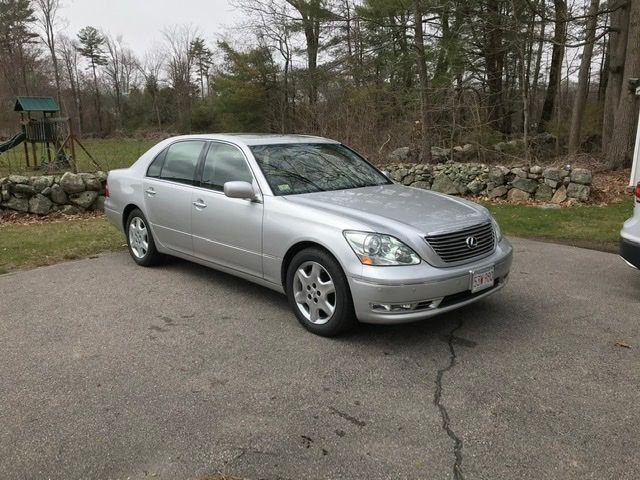

It finally stopped raining to add pictures

I hated the ASH interior but it grew on me quickly. Looks like a great car to start with!

I agree with you. I would Have preferred black but at least it is in very good condition. I don’t think anyone ever sat it the back seat and very little in right front.

She's a beauty. Clay bar the exterior when the weather allows and you'll be amazed at how perfect the paint is on an LS compared to other cars. For the interior, diluted woolite is recommended for the coated leather surfaces. I didn't have any so used Simple Green, heavily diluted and I was amazed that not only did it clean the surface of body oils, the car smelled clean(neutral) after it aired out.
