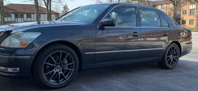

Thank you everyone for all the tips.I decided to try out Discount tire ,since my rims were very bad and one had a bad dent from a pothole I hit , Im pretty satisfied with the new ones and the price was great!! The car even rides better then before I also replaced the front tires with new continental pro contacts .Here are some pics
