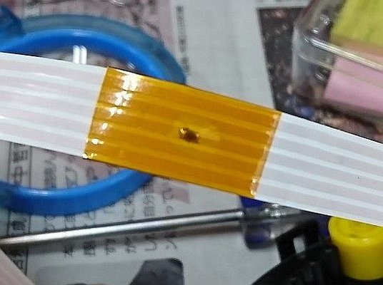

This is about a different car but I fixed the clock spring just soldering the cracked point after finding the damaged part.
What I did was to remove the surface and polished the point as was like this.
Then I soldered it and used a Kapton tape to protect. The car had been OK for nearly 4 years until it was sent to a junkyard due to other issues. The clock spring was still OK at that time.
