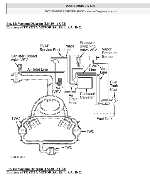

Some detail for 2004 LS430.

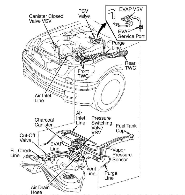

This looks to be a GS. Is location of Charcoal Canister identical on LS?

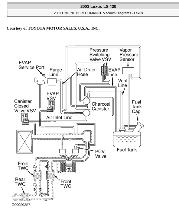

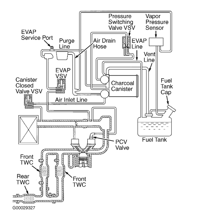

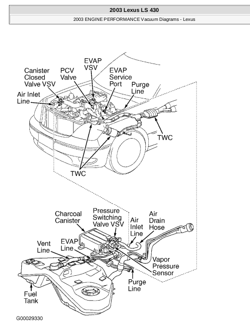

Interesting- maybe it is similar to other models- here is zoomed out on the page to see better for 2003-2004LS430.
Here is another might be interest for you.
Thank you. Parts in diagrams are in different locations but the general path of the vapors is understood.
No prb, plz check updated pics above- there were multiple drawings in the detail for some reason so see if these match better for you.
Got it. Very helpful. Thank you.
