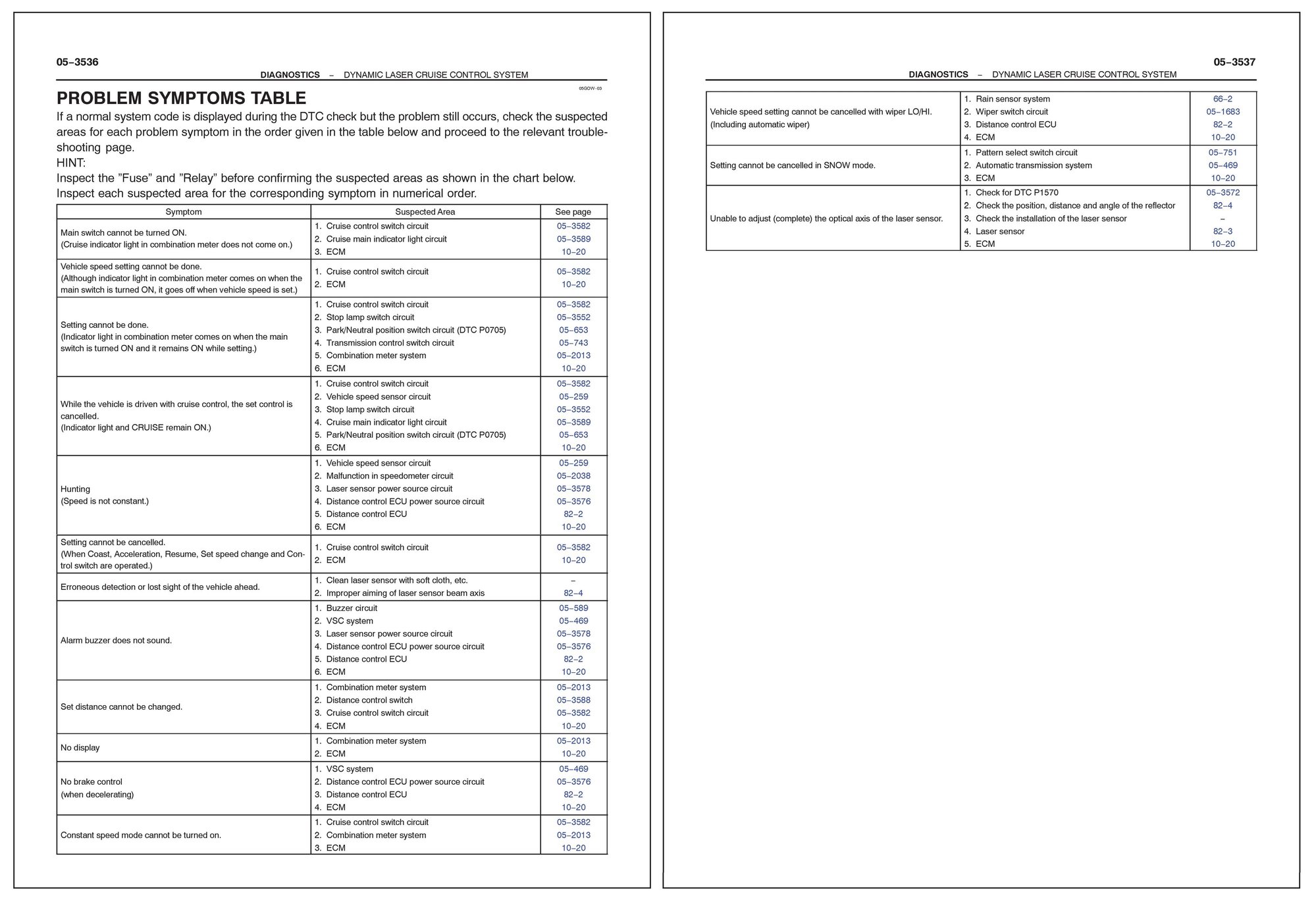

Here's what the repair manual says...

I have an 04 UL with adaptive laser cruise control and it will occasionally drop out while driving for no apparent reason. It will not reset while driving. The car has to be stopped, turned off, and restarted before it becomes functional again. rkw 77080 do you have a similar Problems Symptoms Table for my car that you could share? That would be appreciated. Thanks.
