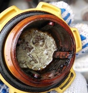

I see similar symptoms at my local shops in winter days. The engine oil partially colored like a milk coffee and a filler cap is something like this below.
This happens among cars driven by housewives who don't drive long distance in cold winter days. They just drive to local grocery stores and others just for shopping. The moisture trapped in the engine causes the problem. Sometimes a failed PCV valve causes the problem too.
