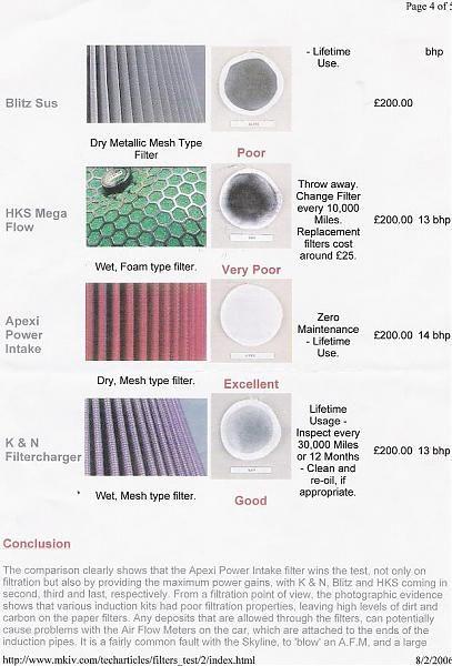

Look at the post above your post old son !!
The test results tell it all .
I had to get the Lexus F sport filter for my wife's IS250 from the States as Lexus in Australia do not stock and are unable to get it even though its sold by Lexus in the Good old USA !!
Previous to that I constructed an enclosed box fed by the stock cold air feed on my wife's LS400 with an Apexi dry mesh cone filter in it and we run up 250,000 K's with it like that .
The LS did actually go better and have more MPG as well .
I run Apexi dry mesh filters on all my cars as the filter is as good at filtering if not better than stock flows more air and last a very long time .
When I find where to get one I'll post it up .

So "results" aka just a number with no dyno chart or parameters to prove it, those are your results? Oh, btw that "article" you linked with "results"...is from an MKIV Supra Forum, not results off an LS430.
Yes, a better flowing filter should net a few HP, but are you gonna feel that? Doubtful.

You honestly think that in a dyno test on a Supra that shows a bit more HP that the same would not apply to another car....Really !!
