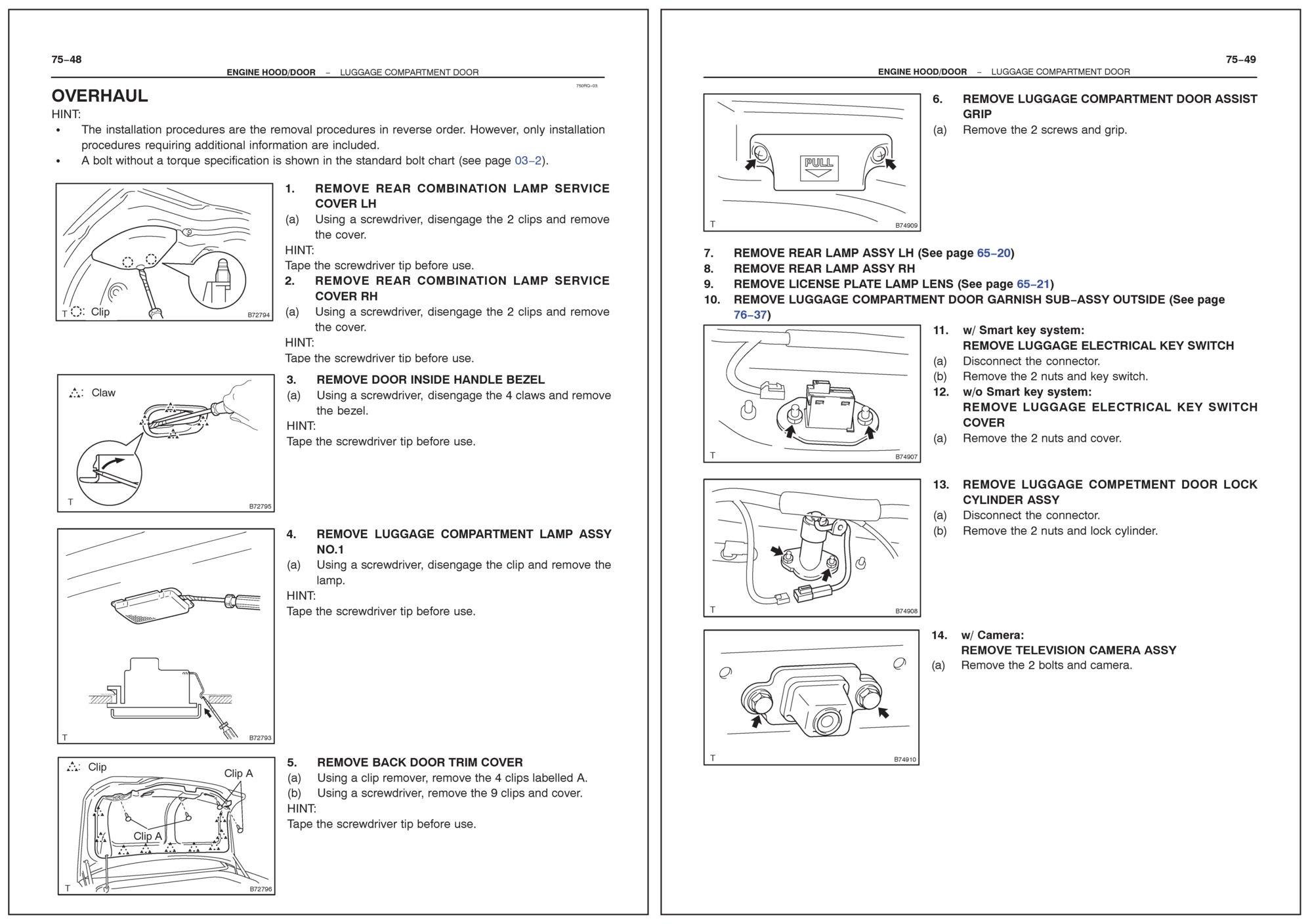

I've had an intermittent camera failure in my 2004 Ultra for quite some time now, and I've just sourced an OEM reverse camera. I'm just trying to gauge how difficult this replacement is to plug-and-play. Is it as simple as removing the trunk liner and popping it off?
If anyone has photos or a walkthrough, that would be greatly appreciated! Thank you.

Thanks for the helpful diagram! I'm a bit confused now - all those things need to be removed from Step 1 to 14 in order to access the assembly? Pardon the ignorance - my LS is actually parked 60 miles away until Sunday, so I can't just go out and start tinkering for a few days.

No. After Step 5 where the trunk lid liner is removed, you will have access to all of the internal parts. In your case, skip to Step 14.
