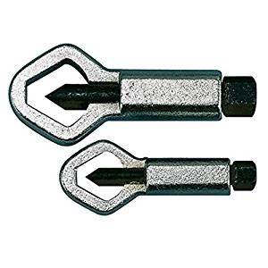

Try call around your local auto parts stores, like AutoZone. They should have loaner "Nut Splitter" you can borrow.
