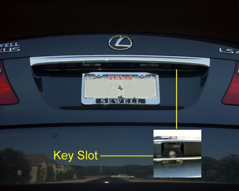

I'm sorry, I've only owned my LS for a few months and I'm still finding out new things about the car. This is going to sound stupid but where is there a key insert to open the trunk?? I remember trying to look for one but couldn't find it...
Let me Google that for you 😉
