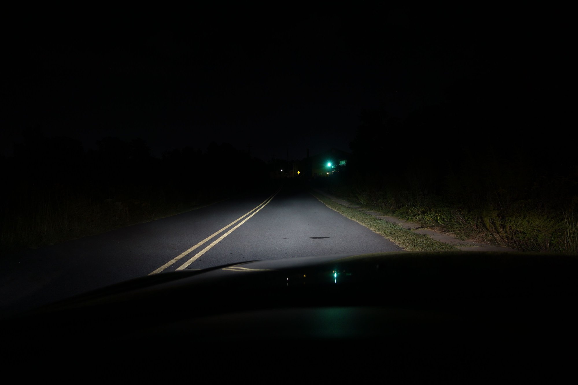

Any reason you dont want to use HID's in fog light housings? LED style will be off-spec regardless in terms of filament location so LED and HID bulbs are both essentially going to throw light differently than the OE halogens will.

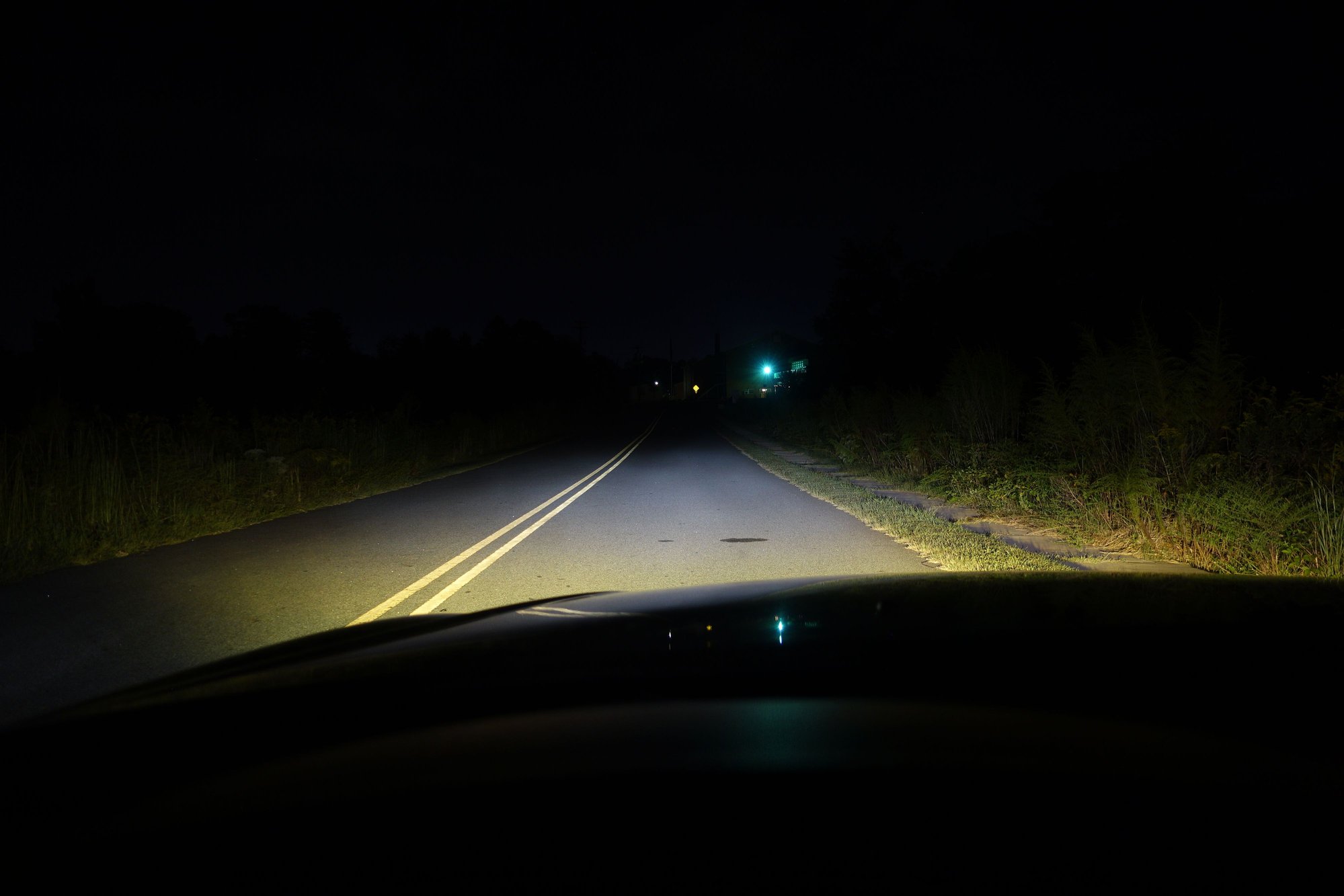

low beam D2R
low beam D2R + fog lights 9006 3000K HID
I don't use these when there's incoming traffic, but the same challenges will be had with LED style bulbs. Both are going to shine the area differently from standard halogens.
