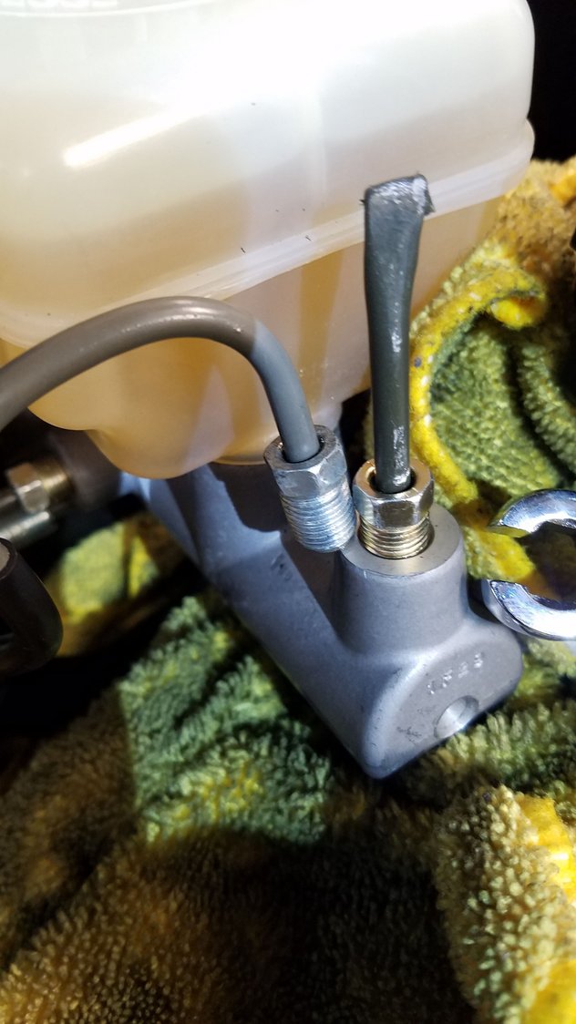

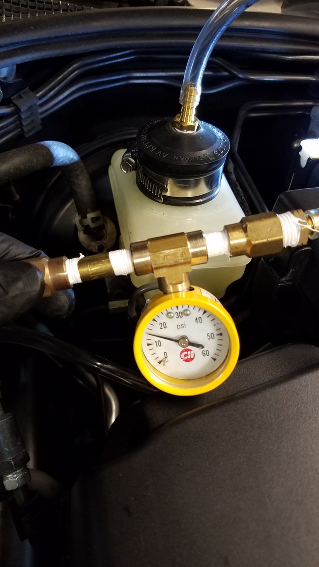

The following worked for me after numerous bleeding of the brake lines. To help get air out of the ABS system. Find a grass, dirt or gravel 'runway' or space to activate the ABS multiple times. Personally, I avoided dry pavement for this procedure as its just too hard on the car, suspension, tires, etc. Drive moderately and safely around 20mph and lock up the brakes on the lose ground, causing the ABS to pulse the brake system. Do this multiple times, 6+. You may even feel the brake peddle will get firmer from just this procedure. Best to follow this procedure with another manual bleeding routine.
I use and prefer pressure bleeding first as shown in the bottom image with a fabricated cap that I made from a visit to the hardware store attached to my home-made pressure bleeding tool. Also typically finish off with a 2 man bleed process to get the best results. Have plenty of quality brake fluid on hand and don't let the brake fluid reservoir run out or you are back to square one with air in the system and have to start over ;-).
BTW, I too thought it may be the master cylinder. To confirm, I sealed off the master cylinder from the rest of the system, using some crimped off brake line adapters pickup from the auto parts store shown in this picture below and tested the peddle, it was as hard as a rock. Moved on to change all brake lines (14 yrs is long enough on the originals) while typical bleeding and fresh pads helped, peddle was still to low for me. The forced ABS procedure above was my solution.
