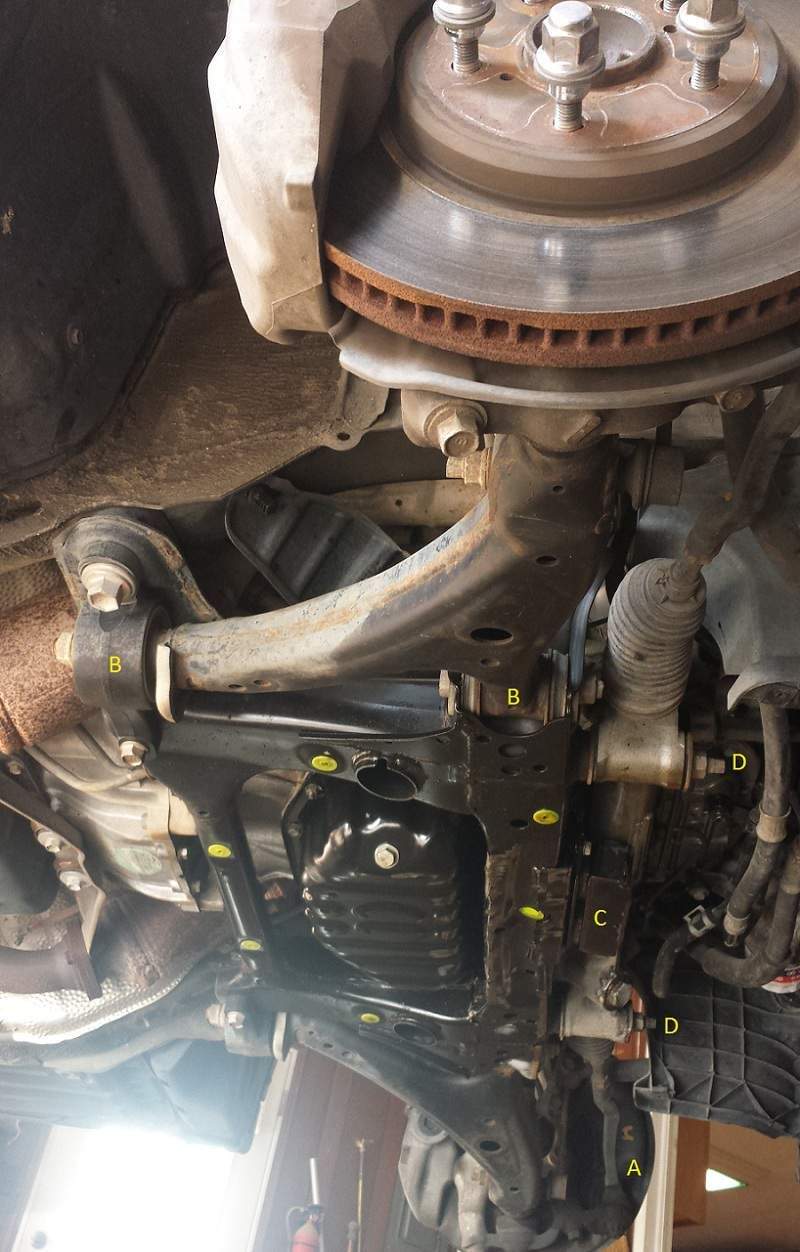

One other thing to check is your sub frame bolts front and back. They tend to work loose over time. When they loosen you get weird clunk noises and weird steering symptoms. 2 bolts loosened on my 2003 LS and after my mechanic torqued them down I experienced major improvements immediately.
Do you know where exactly the sub frame bolts on the front are? Are the lower control arm bushing bolts also the sub-frame bolts?
