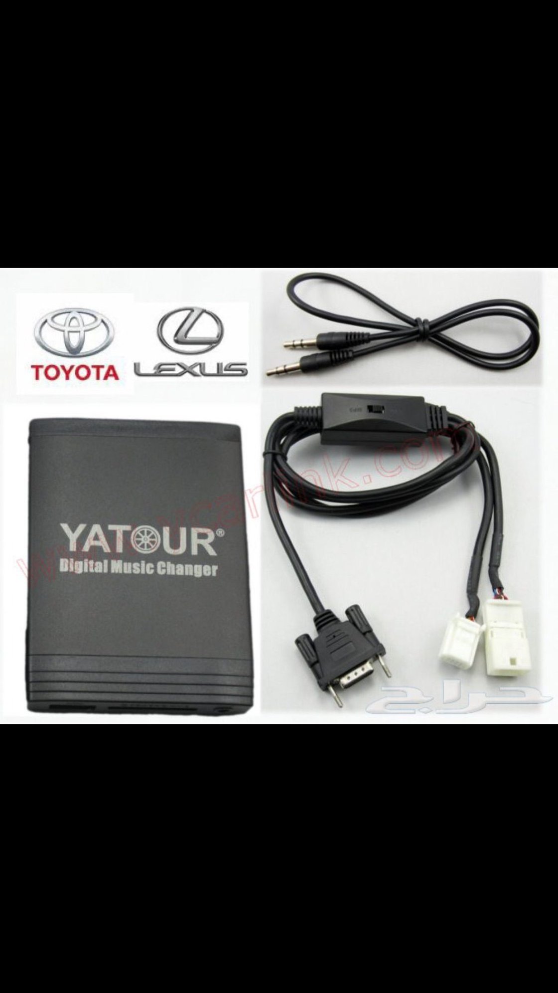

A question for my fellow electric and audiophile gurus. Do these device's connections look like they will provide a real AUX input? What I mean is, will it give me the %100 high quality sound audio that newer cars are equipped with? Or is it some sort of an override over AM or FM waves that sound terrible?
You guys think it looks like a good option, or is it better to just stick with a VAISTECH?

KiNg, I'm a VaisTech MML guy, others like Grom. The wiring on this unit: (1) Does the plug in harness actually fit the back of the radio on one end and the CD on the other? (2) It looks like a basic splice (daisy chain) into the CD system which is similar to the manner in which VaisTech MML is incorporated. Looks like you have to locate an accessible switch however if you want both CD and AUX capability. (3) Is there onscreen info for the Aux input? (4) Can't tell if you can still use steering wheel and onscreen controls for AUX audio. (5) It's hard to tell what sound you'd get. Is there any info regarding output frequency response and total harmonic distortion for the unit?

1- yes, it's specifically made to fit 2004-2006 LS430 models.
2- seller says you can use BOTH the 6 disc CD changer and this device. The controls on the device will appear on the screen as CD #2.
3- no soundtrack names or anything like that. It will only show up as track #1, #2, #3 etc. Just like it would on our Stone Age CD changer.
4- yes, the steering controls will be enabled and should work exactly like it does with CD's.
5- here is the websites URL, I don't really understand the way they have it layed out(Chinese company, seems like). If you can give it a look, that'd be awesome. http://www.yatour.net/shop/?type=detail&id=53

Looking at the wiring diagrams and the instructions on their website, I'm pretty sure they are tapping into the CAN bus for communication and the audio inputs for audio signal. So the quality should be limited only by the device itself and whatever the audio input for the CD changer (or tuner) is in the system. It certainly doesn't look like it's an FM modulation thing. That would have you connecting it to the antenna input on the audio system.
This is the wiring on the 12 pin connector (labeled "B" on the Radio module here) that their 2004+ package would be tying into. The TXM connections are CAN (networking) and the RL/RRs are some type of low level (shielded) input.
