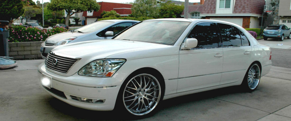

This is on Tanabe SUSTEC FIVE... Lowered about 2" front and 1.75 rear" or about a tiny bit more than what you'd get with coil spring only products like Tanabe DF210 Springs. While it does lower similar stance, there are shortcomings with coil-only products used on OEM struts.

They are Inter-Milano Voltec V
20x9/35mm-5mm(30 with spacer) and 20x10/40mm. The front wheels won't clear the spokes with massive LS430 brake caliper without a 5mm spacer, but it works out to a good offset with it. You can find them online in the USA, sold as MMR Wheels (with different center caps, and are nicely priced from eBay... Around $1800 a set, something like that... Not the best out there in terms of alloy material but it does the job fine for my daily driver. (Gotta have some money left for my wife and kids!)
Front wheels are just about flush with front fender line and it will rub when turned on very low cars. I may grind away at the spokes by 3mm to clear the brakes without spacers and should clear front fender by 2mm (whew! Close Shave!!)
Rears tuck 3mm under the OEM plastic fender molding for a perfect fit!!
I use Yokohama S-Drive Tires, 245/35-10 and 275/30-20...and I LOVE THEM!
