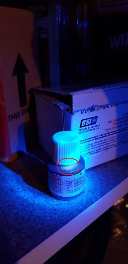

Get some leak detection dye (universal or engine oil), and a UV light source. This will take a lot of the guess work out of a repair.
I use this dye: https://www.brightsol.com/4-in-1-mul...14-oz-bottles/
You can find similar dyes and UV flashlights on Amazon:
Amazon Amazon
