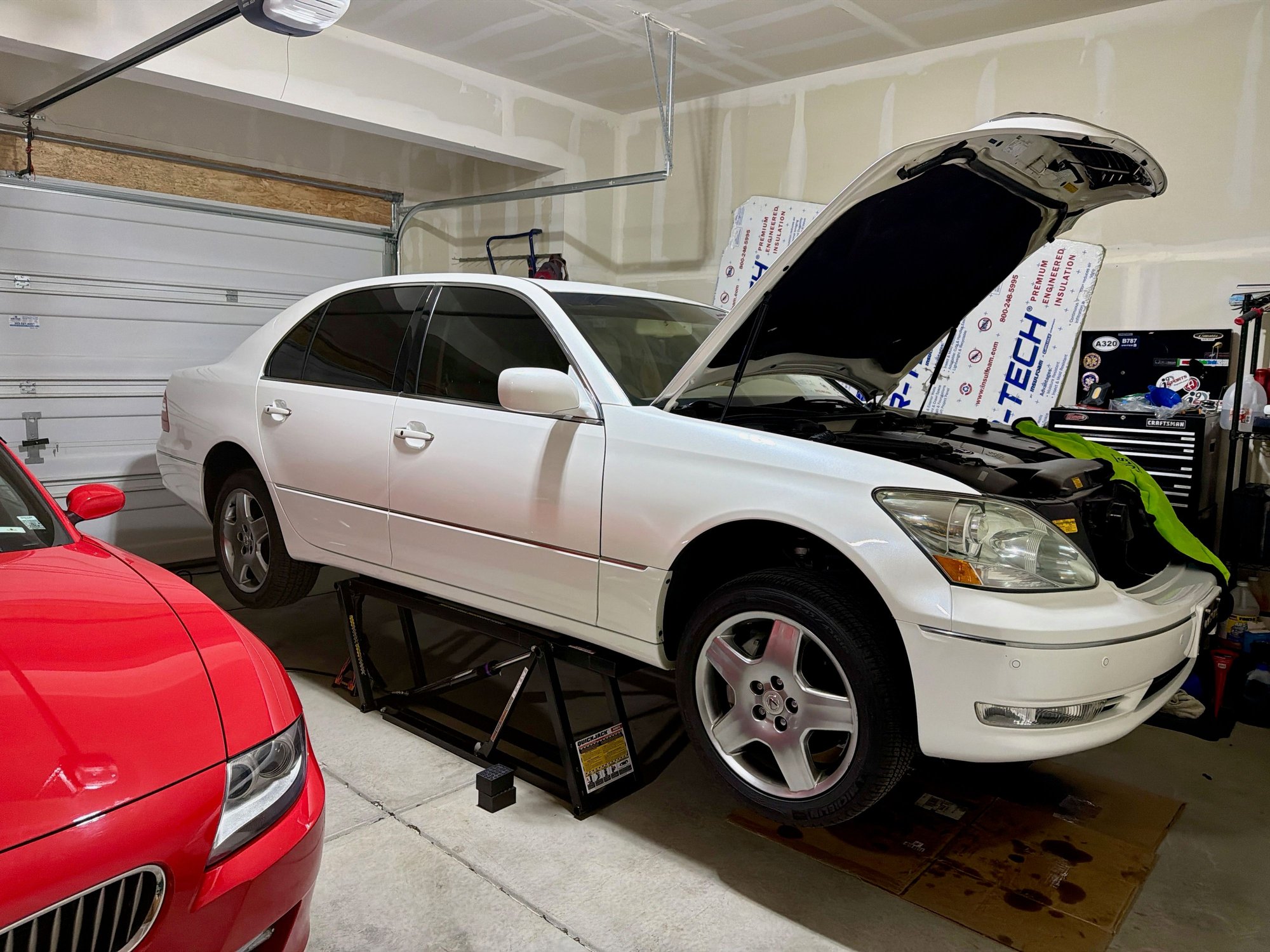

I understand that. My other car is my Z4 (the red one in the pic) and it sits low.. and obviously the wheelbase is shorter. The 8000TL is perfect for the Z4 and lifting the LS430 - I slide the lift a little more toward the front of the car to support the more frontal weight still using the pinch weld points. I have had it up 3-4 times. no issues and it is rock solid on the lift. I even use the lift to detail the car so I can sit down on a roller chair and wax and buff as I go. no bending over all day. .
I bought the 8000 version to also lift my full size truck and medium SUVs in the family
