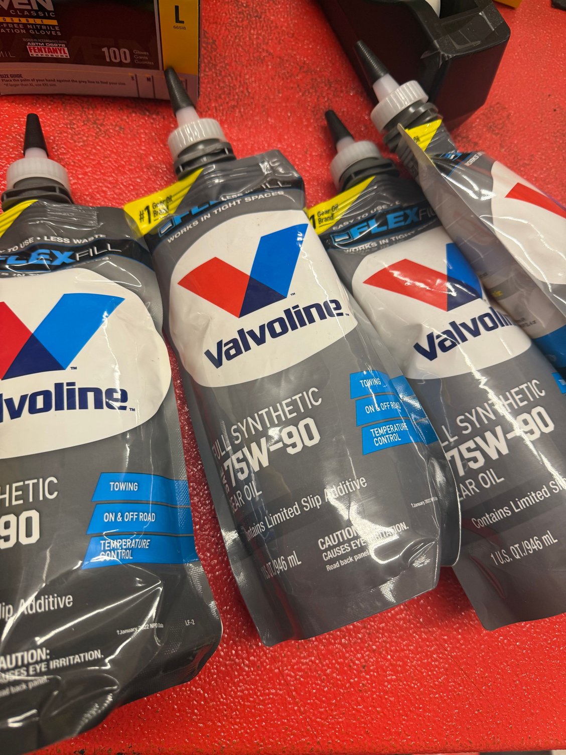

Not sure when the diff service was done on my 2002 LS430.
I work at a parts store and a customer happened to just leave a **** ton of gear oil he never used, do yall think I should use this one?
And how much does the diff take?

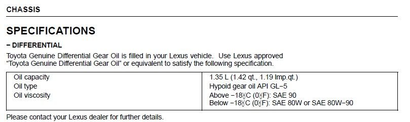

From the 2002 OM:
80W-90 vs. 75W-90? Tow-may-toe/Tow-mah-toe...

Originally Posted by paulo57509
From the 2002 OM:
OK, a bit freaked out now. I have 2005. have no idea what kind I need, but had my diff done 4 months ago,
at a shop, and I remember it said 75w90 on the receipt.. But the manual indicates a specific type, and only if synth required. As per below. Otherwise straight SAE90?
I am wondering if 75w90 was right vs straight 90. Not sure if that page is generic across models or the LS430 varied that year from 1 car to another. And not sure they used synthetic if they did use 75w90. My car has had a whine at 30mph (constant, soft) since then, seemingly from the FRONT, so I didn't think twice about this so far. How sensitive is the LS430 if it is not Toyota spec, and is 75w90 even right vs straight 90? I realize it is years later and oils may have improved etc. but in past at 60k and 120k did diff fluid at dealer... not that they could not use wrong viscosity/spec themselves. This time, not a dealer.

Thanks, reading further, the warning to meet spec seems that it requires synthetic, which is now the default for diff fluid. It seems it was more a warning if you had the special diff to meet it, rather than not to use 75w90 on the other older style diff. I believe 75w90 syn is by far most common today and basically backward compatible, kind of like how 10w30 today will meet an older standard. They probably said 90 otherwise (if not on placard) since it was cheaper then.
There are exceptions, like GM cars may need Dexos (for warranty at least), but I think you are right that 75w90 synth (the modern standard) is fine. For my 6-speed transmission, however, WS only!

NO LSD in the LS430 unfortunately.
I would have no hesitation using that fluid that you pictured, it will work 100% fine in the LS430
