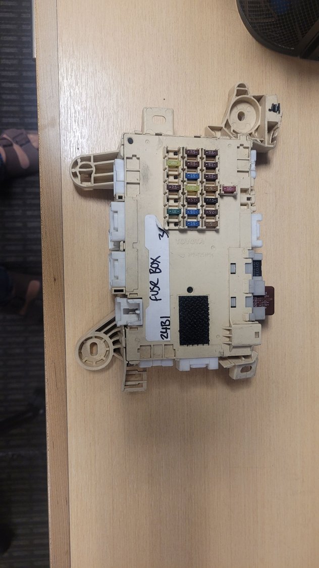

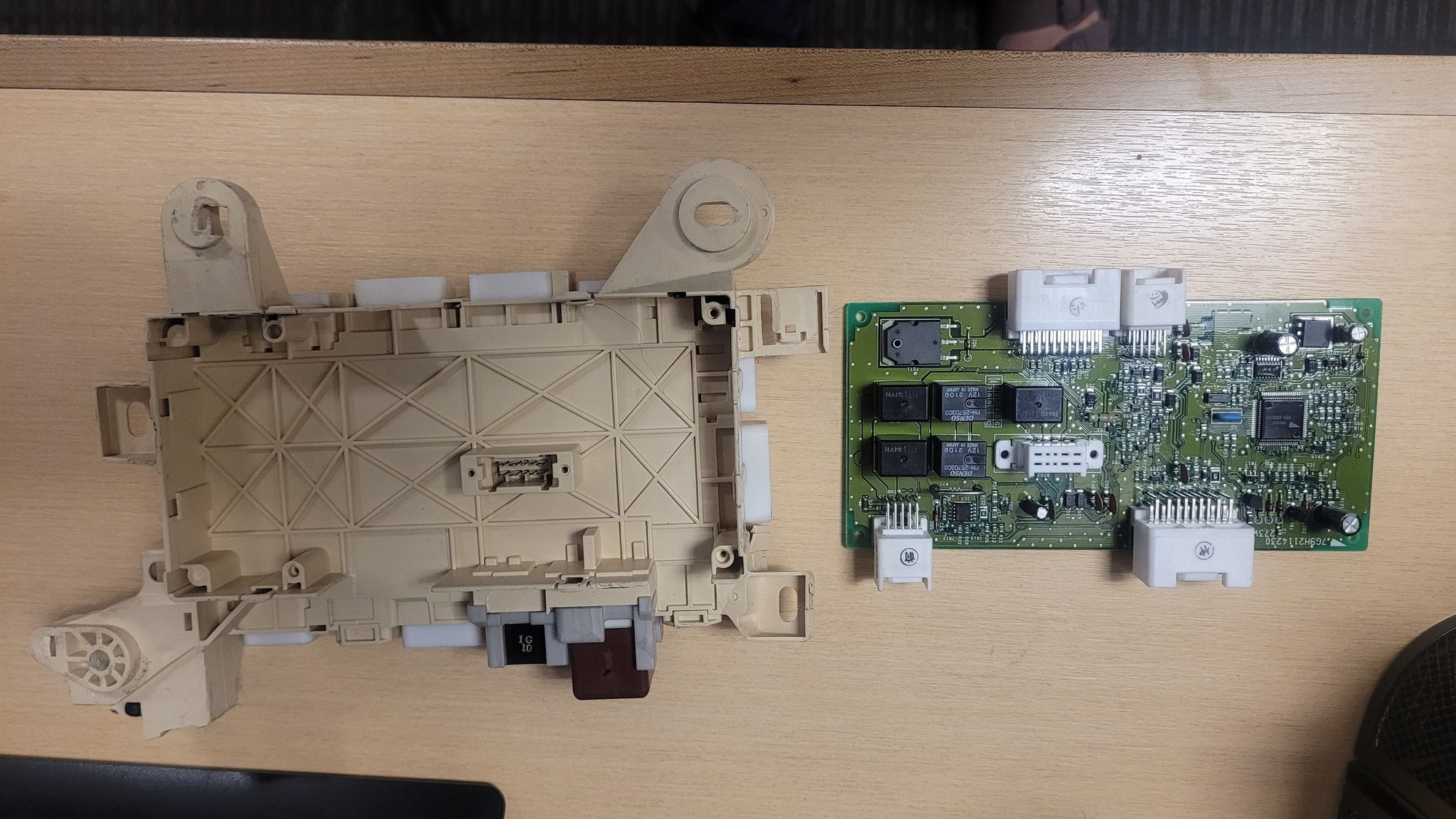

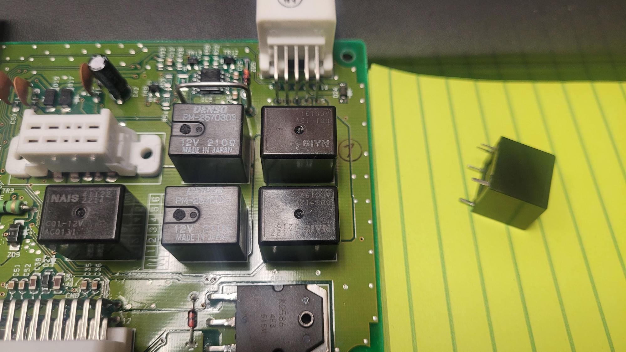

BASED ON A 2004-2006 LS430
On the lower left side of the kick panel, locate the junction box, when you tap or kick it you are getting the relay to connect. I have attached pictures of the junction box. Remove and disassemble, locate relay and if you have good soldering skills replace the relay, I forgot which relay it was, but part available online.
Song Chaun 895-1C-C
Song Chuan 895-1A-C
five pins  one on the left and two on right

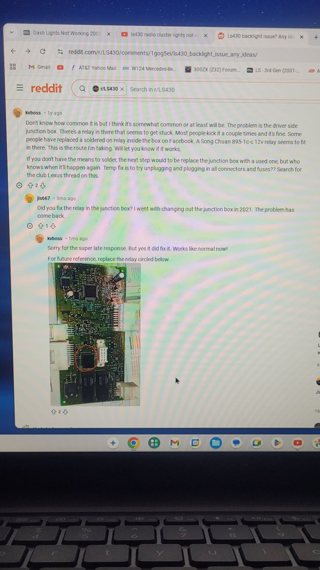

Found the article months ago, I included a picture of it the single one towards the center.....

Thank you, thank you, thank you @RakNaks ! This is exactly the information I'm looking for! I've already found exact replacement relays on-line. I'll buy one and replace it. Looks nice and easy to swap out at least.

disconnect battery of course
Two 10mm bolts, get a metal long trim panel remover, and yes the fuse panel trim is flexible and yes bend that MF around the parking brake. The yellow cap is like a door, pinch both end and swing up!! (you will know when you get there) various connectors and small screwdriver will help!
